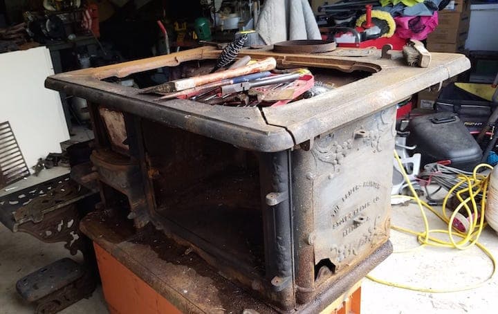

Q. We have an Enterprise oak #215 we can't find any like it on the net to see if we are missing any parts and how old it might be ... any help is appreciated.
19039-elizA-1  19039-elizA-2  19039-elizA-3
Elizabeth Authement
- sulfur, Louisiana usa
April 4, 2014

Q. I am trying to find out what this is and what does this do on the back for my Enterprise wood coal cook stove? It's a spring looking thing with a wing nut on a threaded shaft that can be adjusted and I'm just trying to learn about the stove and any help would be appreciated. Thank you.
19039-13a   19039-13b
Brent cohick
- Mount holly springs Pennsylvania
December 4, 2019
A. It is the spring hinge for the oven door of your cook stove
Kathleen Ford
- Ontario, Canada
January 5, 2023

Q. My husband and I have tackled the task of refinishing an old wood cook stove to use. He completely disassembled the stove and is in the process of putting it back together. My question is, what to do to the actual cooking surface. Paint or not to paint? Condition it as you would a cast iron pan?
Brenda Rude
retired from health care - Marquette, Michigan US
February 17, 2012
A. Hi Brenda. There may a bit of a semantics issue here. If it is a griddle, it would need to be seasoned like a cast iron frying pan. But if the surface is one that you put a pan onto, then stove paint ⇦ on eBay or Amazon [affil link] or stove polish on eBay or Amazon [affil link] is probably fine.
