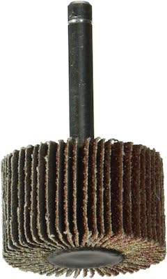

A. Hi, Janis.
1. Depending on how heavy the rust is, you can scrape some off with a putty knife, then remove the rest with sandpaper. The suggestion for the drill meant that if you have an electric drill, you can get a wire brush or sandpaper attachment of some sort.
that fits in the drill and will save you some elbow grease.
2. After you've removed what you can, you can apply naval jelly
which turns the remaining rust into a more stable form. This is just brushed on; it doesn't require heat.
3. Stoves get hot, so high temperature stove paint ⇦ on eBay or Amazon [affil link] are more appropriate than general purpose paints.
