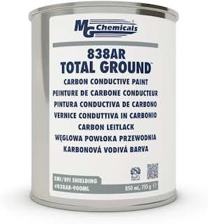

A. I am using MG Chemicals Total Ground spray to coat clay sculptures for electrotyping. So far so good. I am totally new to all this, but I have enough electricity and chemistry to understand the variables. I am using homemade electrolyte. I want to keep the cost down. This stuff is meant for creating a grounded work surface, so it is highly adhesive and highly conductive.

Hi, Judy. Hopefully, you'll get more info on the homemade electrolyte and an opinion about the method.
You can buy MG Chemical Total Ground from Amazon or use your search engine to find it. This site is possible because supporting advertisers provide it for camaraderie and technical information exchange. It's certainly no problem if people prefer to buy from non-advertisers -- but we can't ask our advertisers to pay the costs of maintaining distribution info here for their competitors :-)
