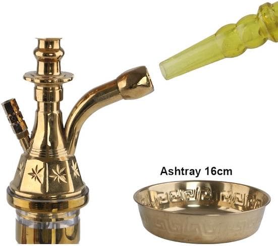

Q. Hi all,
I'm facing lots of plating problems. I electroplate zinc based die casting product (mazak 3). I get bubbles problem when, after electroplating, I bake my product after lacquering process. Please help me to solve my problem
47424-1
Arshan Shaikh [returning]
- Mumbai, Maharashtra, India
May 30, 2018
A. Hi Arshan. We added your inquiry to this thread because it seems closely related to the problem you are describing. Please review it and see if it helps at all.
Do I understand that nickel is the final electroplating step and the color comes from tinted lacquers rather than gold plating? Does the plating bubble if you bake the parts without lacquering them? When you break the bubbles, what do you see (copper or nickel on the base? nickel or lacquer on the underside of the bubble? Thanks.
Q. Thank you so much for your reply, Ted Mooney. No, nickel is not the final step. Nickel I use for local market. Sometimes export-oriented product requires nickel-free plating so I give high shine in acid copper then whatever final finish -- for example, gunmetal or gold or nickel-free white finish, etc.
The problem I face is: when I pre-clean and then cyanide copper, then I directly do nickel, and after that gold plating, then lacquer; then I bake at 120 °C so no bubbles comes on my product.
But when export oriented product requires nickel-free plating I pre-clean it, then cyanide copper, then acid copper, then whatever final finish like gold or gun metal, then drying in the dryer; then I lacquer it and bake: bubbles come on 70-80%.
What I want is I want my product to get baked at 120 °C for 20 mins so I will get high shine and lacquer hardness. How do I achieve it.
The photo which I had shared here is nickel-free golden plating. After baking I got those bubbles.
