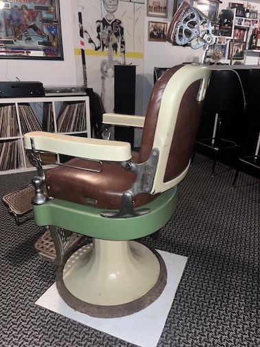

A. I recently disassembled my grandfather's antique Paidar Chair. It too was stuck in the up position and would not rotate either. I found the solution by trial and error, but the gist of it is, there is a "key" in the column of the piston. As the chair rises, the key is slowly pushed out to stop the chair and lock into place. When releasing/lowering, the column lowers and the key recedes.
Your/my problem is/was someone has/had raised the chair to an abnormal position causing the key to "stick" and the chair to become locked. I disassembled the entire mechanism including operating arm to the piston/ram and ultimately "tapped" the column downward until it began to free up. I say tapped, as I do not believe a good whack would be appropriate and I didn't want to damage anything within the cylinder. Once lowered, the key/wedge will fall back into place and the chair will spin/lower/raise.
Hope this helps.
