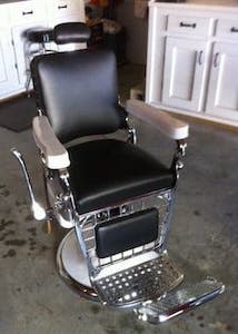

A. I just finished overhauling the mechanics on a 1959 Paidar for my barber.
To restore the reclining function you must remove the housing that contains the two plates and the rod.
First remove the pin that attaches the rod to the upper footrest. Remove the screw on the back, opposite side from the footrest. The round assembly with the rod through it should now be able to be removed by pulling it straight out from the shaft. Remove the two screws that hold the cover plate on. Squeeze the two plates together and see if the rod moves freely, if it does not the shaft will need to be removed and any galling or damage on the shaft will need to be lightly sanded out.
The chair I worked on did not have a cotter pin on the back end of the shaft. This was the case on the chair I worked on. I sanded a few small drags that had raised metal and used a scotch brite pad to clean up the shaft. The shaft should slide freely through the housing and the two plates while everything is apart. I lightly oiled the cup in the back of the housing where it slides through the small diameter. Slide the rod through the housing and one plate, install the spring and 2nd plate. This can be a little tricky, you must squeeze the plates together so the rod can slide while you line up the holes and get the rod back in, pushing the back of the cup will help with squeezing the plates. Once in, squeeze and slide all the way up to the spring.
Now to get the cover back on, you must squeeze the plates and push on the back of the cup in the small diameter, the plates should stay squeezed. Place the cap over the one plate lining up the square pocket, now push the cap towards the other plate until it drops in to the square opening on the cap. Hold the cap in place and install the two screws. You should be able to push the cup on the back of the housing and slide the rod in and out now. I lightly oiled the outside of the housing where it goes inside the base and reinstalled it. Make sure the housing can twist or pivot. On the chair I worked on the screw that goes into the groove could be tightened to the point that it locked the assembly from being able to rotate. I added an extra washer to prevent this.
I was unable to properly install the housing cover without removing it from the chair, the one plate would cock the wrong way and I couldn't get it to drop in the cover pocket. I believe this is because the twisting on the handle does not push the cup in as far as needed to reassemble properly, the cover can screw all the way down with one plate in the pocket and one cocked the wrong way. From what I found online, it is common to crack this cover plate by attempting to fix this improperly, as it was one of the only parts with a modern replacement available.
Hope this helps.

Q. Hey Johnny, I have a chair similar to the Kochs above. it was working just fine until I took it apart and polished everything. Likely story huh?
I'm currently reassembling the recline mechanism. I took everything apart and cleaned it good. sanding down any buildup or dings. I can get the cover on just fine by pressing in the back plate but it doesn't seem to release all the way even with white lithium grease. It also feels like the handle itself doesn't want to engage properly or fully.
I also don't have the spring in front of the footrest arm like I've seen on here. Is it necessary? Again it worked just fine beforehand. Also the spring at the lever rest is broken but seems to do fine as it's still in place.
