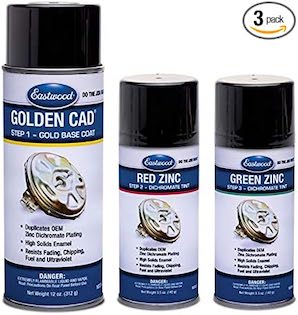

Q. SO IT IS NOT SAFE TO DO IT OURSELVES , FINISH OUR OWN CARBS. QUESTION IS “WHAT PAINT IS AVAILABLE THAT LOOK’S LIKE SAY HOLLY OR ROCHESTER CARBS. I AM NOT BEING SPECIFIC ANY REASONABLE PAINT WILL DO. COULD BE IN A CAN AND COULD BE DUAL ACTIVATED PAINT IN A CAN, MUST BE IN A SPRAY CAN PLEASE. WHAT ARE THE CHOICES OUT THERE ?
MICHAEL BOSCARINO
hobbyist – COCONUTCREEK FLORIDA
September 19, 2021
3-step Paint to
simulate Golden Cad
carburetor_paint
on Amazon or
A. Hi Michael. I don’t think anyone on this thread said it wasn’t ‘safe’, although strong & regulated chemicals are surely involved. But they said the likelihood of successfully re-chromating a carburetor without first zinc electroplating it was low.
Yes, there are spray paints intended to look like the gold/yellow chromate coating on O.E.M. carburetors. Eastwood has a 3-step system where it looks like you paint the whole thing with their gold color, then touch up with little streaks of red and green to give the iridescent look. But I can’t say how well it works.
September 2021
September 20, 2021
Ted, years ago I researched the same system you’re talking about. One of the carb. re finisher & Tri-power builders gave the information away. So I just asked him recently if I can use this same finish on the Rochester carbs, and he said no. He wants me to buy carb. renew 2 that Eastwood can’t get from China at this time. So I figured he lied because I wrote the formula down about “Golden Cad and Red /Green”in my notes. After reviewing the notes I found that he did use this kit 7-8 years ago. Anyway, there goes the trade secret.
So I just got off the phone with Eastwood and we came up with this system:This is what I am going to try on my 1966 Pontiac Tri-power Rochester carbs:
1) Media Glass Bead the parts on the outside only.
2) Since I polished these carbs before and did not clear over them, they dulled too soon; but I believe that 3 different polishes and 3 different wheels could have closed the pores of the metal enough that I won’t have to repeat the process again. Triple polish the carbs first, then media Blast.
3) Prep.and Paint using 16160Z Golden Cad 3-step Eastwood red/green. Apply Golden Cad first on Body and air Horn and certain Linkage parts that you choose. After normal prep. is completed then lightly over cast an Antique look with the Red and Green. Use Silver Cad on some of the linkage also #10022Z. I am going to use the silver cad on the lower Throttle Bodies.
I am not spraying any paint on the inside nor am I painting the valves. Plug off any holes with wire or pin so you don’t have to rod them out later as much. Next, clear with 2K Matte Clear # 14792Z. This clear is the 2-part can that you activate the hardener.This will protect the entire job according to Eastwood.
I will post the Pictures on this site when I am done and I will post any problems that I run into so people won’t make the same mistakes. Linkages won’t get the Red or Green over spray like the Air Horn and Body. All Linkages will get cleared. All linkage will be media Blasted to remove any existing paint. I am going to clear coat as I go and try another clear coat when the parts are assembled if I deem it necessary.
