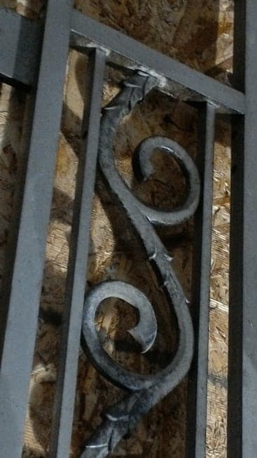

Q. Hi, my name is Caleb. I work for a historic restoration company that is currently on a project restoring an anodized aluminum storefront built in the 30's.
The storefront itself is pretty straight forward. gentle detergent and soft scrubbing seemed to work well. however, there are also ornate cast "screens" that attach to the storefront. These, along with more exposed portions of the storefront, are pretty severely pitted and discolored. I believe these areas have already lost their coating? I'm also concerned that harder scrubbing or sanding may remove, or may have already removed, some of the anodized finish.
14122-1a   14122-1aThm   14122-1b   14122-1bThm
I'm hoping to find the quickest/least expensive solution to cleaning these. Just trying to achieve a cleaner more uniform appearance and address the worst of the pitting. Is it necessary to re-anodize the entire surface? If we just scrubbed and didn't re-anodize anything, what kind of corrosion might I be looking at in the future? Could you clearcoat to help protect the areas that have lost their coating? or would it just be faster and better quality to clean and then re-anodize with some sort of paint on product? any advice is appreciated as aluminum is not something we are used to working on...
Thanks so much,
Caleb Joy
historic restoration - Seattle, Washington USA
March 29, 2019

A. Hi Caleb. Quite a beautiful storefront!
Detergent should not hurt anodizing as long as the detergent is not strongly alkaline. And scrubbing should have no effect (it's reasonably hard to remove anodizing with sandpaper).
Re-anodizing pitted material is troublesome, so I'd probably suggest the clearcoating.
Our supporting advertiser, Everbrite [a finishing.com supporting advertiser] has been involved in significant restoration works per my understanding, and contacting them would probably be worthwhile.
