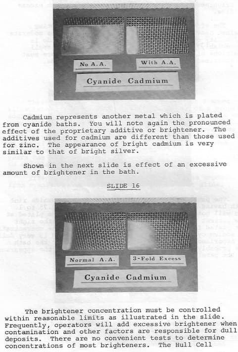

A. Hello again, John. Thank you for the kind words.
I don’t know of any current presentations on Hull Cells for cadmium plating, but if we go back 50 years, here’s a page from AES “Hull Cell Tests for Quality Plating” covering the effect of too little and too much brightener. There were color slides corresponding to the printed B&W photos but I misplaced them, probably 49-1/2 years ago  🙂
22320-3ext
Google finds an almost endless list of Hull Cell presentations and videos, so I can’t view them all to suggest the best, but I think both of the following are quite good:
“Interpretation of Hull Cells, How & Why” and
“Interpreting Zinc Plated Hull Cell Panels”
The zinc plating is similar enough that I think the above video will be quite helpful. Basically you will probably see burnt plating at the very left edge, and little to no plating at the very right end, but you should ideally see good plating all across the current density range except for the true extremes if the brightener level is right.
If you send a pic of your Hull Cell panel for posting here, hopefully a reader will be able to make suggestions. If it doesn’t photograph well because of the shininess, the professional approach is to reflect some screening in it; if that’s not available, perhaps reflecting a page from a book might suffice although I haven’t tried it  🙂

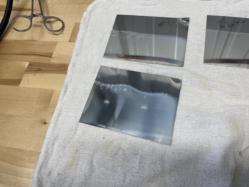

Q. Hello again,
We have preformed several Hull Cell Test on our Cadmium solution.
Thank You for your advice.
We ran the test for 5 minutes at 1 amp.
I have attached some photos of what the test revealed.
22320-4b
22320-4a
Hopefully we can correct the tank. I do not think we are that far off.

A. Hi.
I am neither a proficient Hull Cell user, nor a chemical technician, so I hope other readers will chime in, but the lack of brightness of the deposit in the low current density (if that’s what I’m seeing) seems to indicate shortage of brightener rather than excess.
Maybe add one drop of brightener to the Hull Cell and stir before trying your next panel and see if the panel gets better or worse.

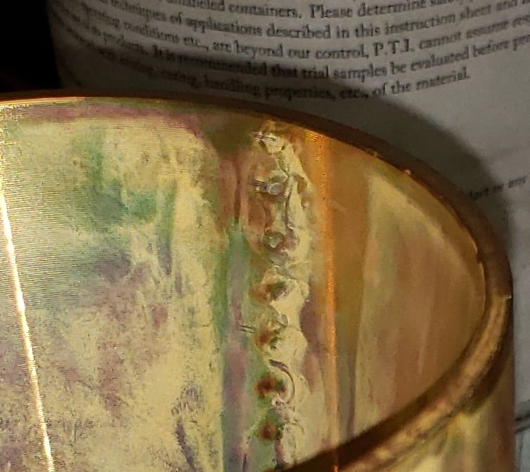

Q. What are these crystals seen on the surface of cad plated parts after plating? Why are those crystals building up?
crytals on cadmium plating
Mary Marin
– Los Angeles, California
September 11, 2023
A. Hi Mary,
This looks to me like it may be cadmium bloom, which occurs when cadmium reacts with certain organic acid vapors. The most common cause for this is improper storage in certain types of wooden containers. Heat and humidity can cause vapors from the adhesives to diffuse into the air and react with the exposed cadmium. Be very careful! Cadmium is a dangerous poison, and those white crystals can form an inhaleable dust when handled.

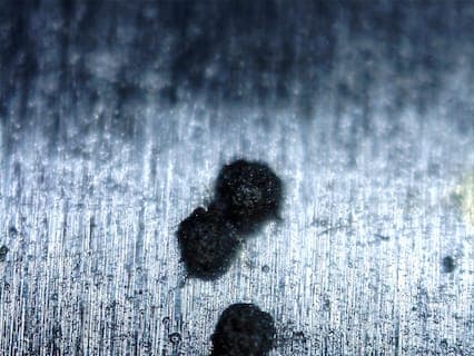

Nodule Problem in Cadmium Plating
Q. We run a sulfuric-acid cadmium process on steel substrates in two separate identical tanks (two plating stations each). We recently dumped one of these baths, suspecting it had become contaminated. Since we made this new bath, we are getting extreme roughness in the form of tiny nodules, which form everywhere except the underside surfaces, as the parts are positioned on the rack. Under magnification, these nodules look like tiny brown warts. If you scrub the area with a scouring pad, the nodules shine up like the surrounding cad plate surface.
nodules in cadmium plating 60554
We have ruled out cleaning. Parts from the other tank do not have this formation. Bath parameters for temperature, acid and metal content, etc., are in range and comparable to the other tank. No leaks identified. We filter these baths with .5-micron cartridges and have no detectable particulate in solution. Is this some sort of stress formation? So far the only difference we have detected between the two tanks is rectifier ripple: the roughness tank has 8%, while the other is only 1%. Even so, 8% doesn’t strike us as alarming, but we are working to bring that down.
We use iridium-oxide inert anodes (instead of graphite), and our cadmium anode baskets
⇦ huh? are bagged.
Any ideas? Our chemical reps have all but given up.

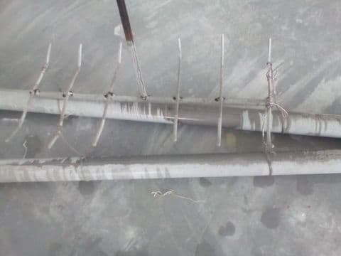

Cadmium anodes turn black only during plating
Q. What would cause a black film to form on cadmium anodes while plating that would dissolve very rapidly off the anodes when plating is complete.
Don Davis
American Airlines – Tulsa, Oklahoma
February 12, 2020
A. Hi Don. This might depend on whether the bath is cyanide, acid, Ticad, LHE … so it would be helpful to know. Thanks.
Q. The plating solution in respect to the post is LHE cyanide cadmium. The film does not seem to effect plating efficiency or HE.
Don Davis [returning]
A. In a common cyanide cadmium solution the anodes turn black when the free cyanide is too low. Get it back up to about 18 oz/gal and the metal around 3 oz/gal, try it in a bucket first and see if the black goes away and you see clean cadmium color.
robert probert
probertbanner
A. Maybe it’s turning black because you apply high (very) voltage? After you switch off, the anode turns to normal?

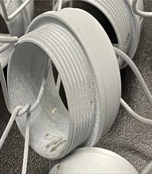

No cadmium plating coverage on large or rough parts

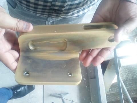

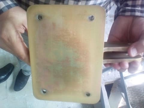

Q. We have encountered a problem with our cyanide cadmium plating. After 20 mins of plating with 25-35 °C temperature and 2-5 Amps, still the plating is missing on several parts of the job. Plating happens well on small and smooth surface parts but not on un-smooth surfaces and large parts. Keeping in mind that the job is well stripped and degreased before plating. We have some critical jobs pending I would like to hear your valuable opinions.
Zeeshan Ahmad
– Islamabad, Pakistan
September 14, 2020
Q. We analysed this specific bath and the analysis result shows that every content of the bath is in range. The composition of the bath is mentioned below.
Bath composition :-
Solution Volume :- 576 litres
CaO : 35-40 g/ltr
NaCN : 90-120 g/ltr
NaOH : 20-30 g/ltr
Additives: NiSO4 : 1kg
poor coverage in cadmium plating 49988-2a
poor coverage in cadmium plating 49988-2b
poor coverage in cadmium plating 49988-2c
poor coverage in cadmium plating 49988-2d

A. Hi. I try to give my opinion.
What is the material of the parts?
What is required thickness of the plating?
My opinion,
Plating current is not enough. 2-5 Amps is to low for big parts. It’s working well in small parts, but not in big parts, since your surface area already changed.
Use CURRENT DENSITY (need to calculate to set your current based on surface area of the part) between 20-30 ASF (ampere per square foot).
Refer to the jig picture, it was difficult design for me. It is better to use one hook jig only, and try to rotate the part in interval time of five minutes.
If, after applying above steps, you need to setup new anode that located at the very deep area (plating hard to reach/ cover).

I’m working for ITT Cannon as Plating Engineer for the Cadmium cyanide Process. Recently we got in 5 of our cad tanks a pitting condition around Hull Cell and Parts,; the pit condition is around all the cell (High current density and low current density).
We try to fix using Metex S-3 as cadmium wetter. It works but it does not resolve the pitting condition, we made dummy plate every day since February 2021 with Carbon filtration and i’m looking for advice if the Lead (lead comes from Cad Anodes) could be an issue?
I hope that someone can advise us.
Rodrigo Ornelas
– Nogales, Mexico
April 6, 2021
A. Hi. If the wetter doesn’t relieve the pitting, I’m guessing they are not gas pits (which would be hemispherical and shiny). But if they are, and they are also on the Hull Cells (which don’t get exposed to any polishing/buffing changes you might have made), then it remains as something wrong with the wetter. Are you able to do dyne testing?
A good close up picture of the pits would probably help get us all on the same wavelength, but if the Hull Cell panels do not enter your standard pretreatment baths, clearly the problem is in fact with the cadmium plating solution.
Q. Cad plated parts with yellow chromate look like they were not rinsed properly and allowed to dry.
49988-3a
49988-3dtl
49988-3b
Ken Cullum
Manufacturing Engineer – Lancaster, Texas
February 8, 2022
A. No, it looks like he did not neutralize the cyanide plating solution before going into the yellow chromate solution. Good practice requires a weak nitric acid dip ahead of the yellow chromate, but most job shops do not maintain the acidity of the weak nitric pre-dip.
robert probert
probertbanner
thumbs up sign Thank you very much Mr. Probert.
This is a job for the military and is supposed to be Cadmium Plated per AMSQQP416, Type II, Class 2
