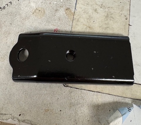

White spots in CED coating
Q. We make a bracket, weld a nut on it and then send out for e-coat. We sometimes get parts back with what appears to be white marks on the e-coat. I suspect parts are not being cleaned properly. Any comments on what this could be? ⇦ Answer?
32574-12a
Larry Hoppenrath
Quality manager - Chesterfield, Michigan
April 23, 2026
A. Dear Larry,
This is nothing but a jigging problem. Your coater is adjusting these jobs on some other job's jig for coating, and hence your jobs are getting these marks as some jobs are overlapping each other and they touch each other on specific spot.
Tell him to make coating jigs suitable for your job so that they don't touch each other.

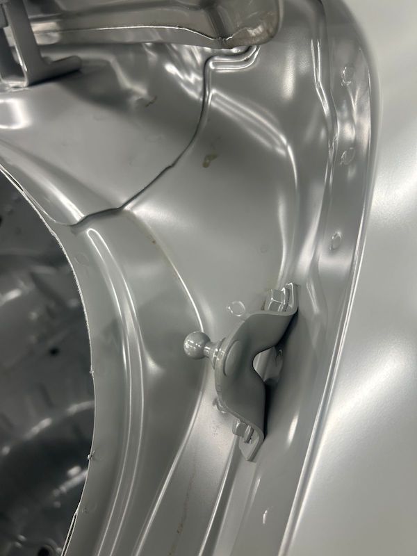

Runs/sags & yellow stains in trunk & gutter areas
Q. Hello, I am currently an intern in a multinational automotive company. We are facing defects in the cataphoresis process, mainly runs/sags and yellow stains appearing on some parts of the car body, especially in the trunk area, downward sections, and gutter zones.
32574-13
I would like to know the possible root causes of these defects and the corrective actions that could help solve this problem. ⇦ Answer?
