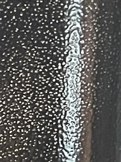

Q. In our e-coat dip paint line we paint automotive parts. We are seeing issues with sporadic parts coming out with what looks to be pin holes. The parts are light in weight and our thoughts are intermittent contact from the parts floating on and off the hanger during e-coat. There is no pattern to which part will come out with this defect. All chemistry is in range.

A. Frankly speaking it seems that nobody can answer your question.
I have faced a similar problem & iI didn't get answer for the same problem.
But I tried different methods to overcome this problem, by stopping the process of coating -- by shutting the current after half time of the decided time and to withdraw the jobs from tank for 1 minute & again dipping it in tank and continued the coating process for next half time. And it worked.
Shop employee - Nashik, Maharashtra
February 17, 2026
That's an interesting observation, Avinash, and it reminds me of something ...
In the nickel electroplating process, we sometimes encounter "gas pits" ⇦ huh? caused by the process generating some hydrogen gas bubbles which adhere to the workpiece, with the nickel growing around them instead of displacing them. They are counteracted with additives which lower the surface tension and the consequent ability of the bubbles to adhere and by vigorous air agitation
⇦ huh?
to knock them loose. Your procedure removes them mid cycle, perhaps explaining why it worked.
If the problem is indeed hydrogen bubbles, the thread includes several suggestions including better agitation and more hydrogen scavenger.

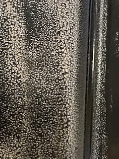

Q. Hello all, I have some problems with painting.
I have an E-coating line almost 3 years; everything was okay until last month. Problem is with non-painted small holes on the object. I think this is not a problem of pretreatment or air bubbles or racking.
My paint supplier suggested that I add more solvent, but this did not help. Does anybody have an idea what is the cause of this issue? ⇦ Answer?

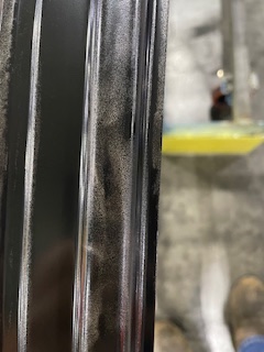

Q. Hi sir,
I am working PTED line and I am facing first time PINHOLE issue in full body. And then finding a root cause is ED Path problem. And how to solve this problem please give me an idea.

A. Hi cousins Nikola and Govind.
Although there are several possible causes for pinholes (as you can review on this rather long dialog on exactly that subject), Larry Durney reminds us in "Trouble in Your Tank" to remember: if it used to work but now doesn't, it's because something changed :-)
His point is that in virtually every case it ends up far easier to determine what changed than to start from scratch and re-develop a workable process. So he says if it used to work, as you report, don't solicit help on theory or what to adjust! Instead:
• Carefully study the records (personally !)
• Insist on the "Letter of the Law" for every parameter -- nothing is allowed to slide from optimal.
Only if, after doing those things, you remain unable to figure out what changed should you attempt the much bigger job of trying to re-develop a workable process ... but this page discusses several possible causes of pinholes if you simply can't restore the original situation. Good luck!
