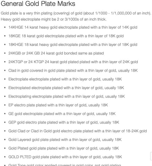

The United States does not use hallmarks. However, many countries with far greater histories of silver-smithing employ, or did employ at one time, a complex hallmarking system. There are a number of excellent guides available on the internet that can assist you in identifying a particular hallmark. Go here: 925-1000.com
Ok this is wearing me out, but I’m pushing on. I think I will leave this as a silver post and do a gold later.
Silver Plated jewelry often does not have any mark on it anywhere that would indicate it was silver plated. Occasionally you will, however, see the following marks:
“SP” – meaning Silver Plate
“Plate” – more common on flatware and table pieces
“EP” – meaning electroplated
“Quadruple Plate” – allegedly meaning the piece went through electrolysis four times
“EPNS” – meaning electroplated nickel silver
“S80” – this is a mark that appears on a lot of Chinese silver colored jewelry that is often also marked 925. This is not silver jewelry. It is merely plated with “925” Sterling Silver. ‘S80 Silver’ is apparently a plating compound in many emerging market countries.

The only thing in your posting which I think might be not quite accurate is “Quadruple Plate”. While I originally believed that it meant the same thing as you did, here is a posting by a very knowledgeable reader, copied from thread 44569 claiming it refers to silver plating 4 times thicker/heavier than some minimum:
A. Quadruple plate contained 8 tr.oz. of silver plate per gross (144 pieces) of teaspoons. The plating was about 1.2 mils thick (.0012″). In 1975, quadruple plate was still being produced, mainly for places like hotel restaurants.

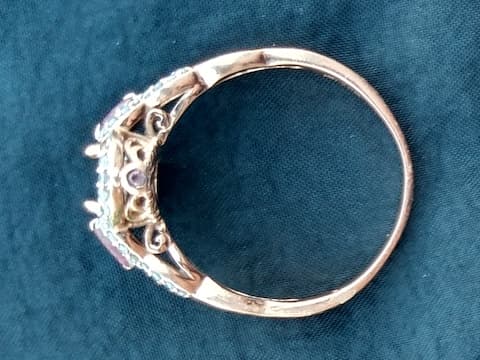

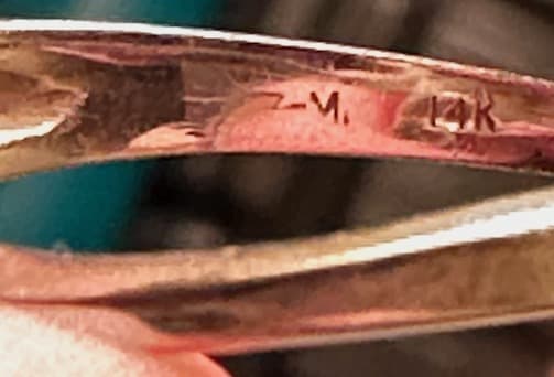

Q. I have a gold ring with initials and A 15 at the bottom inside the ring has inside is stamped with M.JAK do you know what this means?

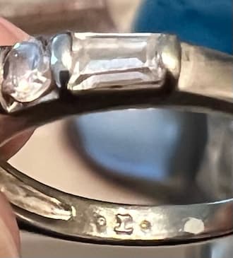

Q. Hello, I have a ring that is marked on the inside as follows; C (circled as if the copyright c) then separately another c that is circled but larger than the 1st, like an initial then a w also circled as if an initial and then 900 pt. The ring is is wide band, the body of which is open cut work 5 petal flowers with stones (diamonds) it was left to me by me aunt, what do I have? Any idea? comments, thoughts are most appreciated. Maria
Maria Goncalves
– Somerset County, New Jersey U.S.A.
October 18, 2017
A. Frank: your ring is probably sterling silver.
A. Maria: your ring is probably platinum.

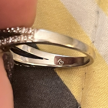

Q. Hello! I have a hallmark stamp on my engagement ring that looks like a beaver tail with 14k and D050 on the other side.

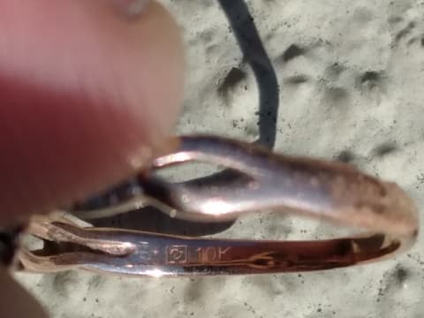

Q. My grandmother had a ruby and diamond bracelet. It had matching earrings & a ring. The bracelet is stamped 14K and I believe A & P. What designer or design company is this?

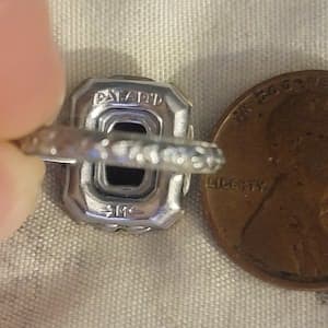

Q. MY WIFE WAS GIVEN HER GREAT GREAT GRANDMOTHER’S WEDDING BAND. ON THE INSIDE ARE THESE MARKINGS: AN H, THEN A CROWN, THEN 18M. DO YOU KNOW WHAT THESE MEAN?

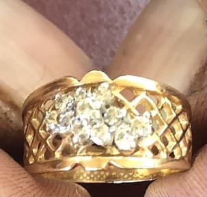

Q. I bought a small bag of jewelry at an estate sale. The ring pictured was in the bag. The marking inside the ring is P OK. Do you know what this means?
gold & diamond ring

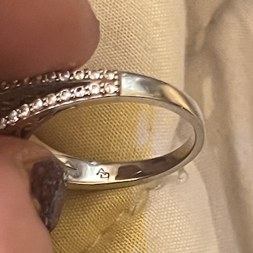

I have a ring with the letters AD on the band. I can’t find anything with those letters. It also had 14k inscribed but I know what that means. Photo is attached, thank you!
29370-34b
29370-34a
Amanda Lynn
– Ketchikan, Alaska
April 25, 2023
A. Hello Amanda,
I don’t get on this site as much as I want but I’ll answer your question and hopefully you’ll see it. The AD on the inside of the ring most likely stands for American Diamond. These stones are lab made and not real diamonds. The 14k means the white gold is 14/24ths purity, which is 58% gold. If this was bought for you as a gift, I hope I’m not getting them in trouble. You do have gold there and a great looking ring however.

Q. I have a ring with a small circle on each side of the letter L
29370-35a
What does this mean, could you tell me please.

Ed. note: What is that whitish spot to the right of the hallmark? If it a chip in a plating on the ring, then we’d at least know that it’s a plated ring, not fine gold jewelry.

A. Hi folks.
That “L with a dot on each side” is a hallmark but there are tens of thousands of hallmarks. None of you have yet offered any info to narrow things down :-(
For example: no one indicated their ring’s age (passed down by great-grandma, or bought recently from a jewelry chain?), any geographical hints (bought in USA, Europe, Asia, Caribbean), whether their ring has any other markings (sterling, 995, 14k, or none), whether the stones are jewels or glass, what the ring is made of, whether it was cheap or expensive. Your fellow enthusiasts might enjoy helping track it down for you if they are offered some hints — but not if their research effort is limited to leafing through tens of thousands of hallmarks from every age, type, material, and geographical origin. Heck, even Google Lens gave up on me without finding it :-)
Please tell us something else about your rings besides the L with dots.

Q. I have a ring that is old and has 83D stamped on the inside. I think it is blue topaz but not sure. Does anyone know what 83D means? Thank you.

Q. Hi! I have come across this piece. I am not very familiar with 10k gold, here is mostly 14 and 18k. I have done my research but I can’t find much info.
gold bead bracelet
Does anybody know if the mark in the picture represents genuine 10k or S10 k whatever that could be?
It would be highly misleading if it wasn’t but that would not be the first time.
