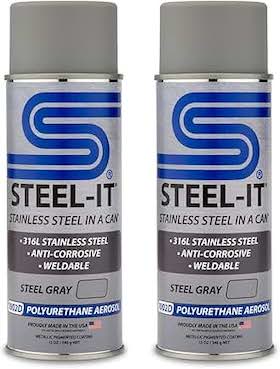

Q. Where can I find stainless steel spray paint. I had some made by State Chem., but they no longer manufacture it. I'm looking for a paint with 100% 316 L stainless steel pigment, not just a color match paint. Also, I do not want an epoxy paint for stainless steel.
- Marietta/Atlanta, Georgia
A. Hi, Rick.
I find these two 316L stainless paints --
• Seymour ⇦ on
and
• Steel-It ⇦ on
They come in spray cans like other paint. They're based on particles of 316L stainless steel. The Seymour says it'd UV & weather resistant, so it's surely not epoxy; the Steel-It says it's polyurethane based.

Q. I am looking for local suppliers of Steel-It in the Philadelphia, PA metropolitan area.
Maybe you finishing experts who might be reading this could guide me in the right direction. I have a stainless steel Thermador cook top in my kitchen which is starting to show its age (approx. 30 yrs) and rather than replace it, I would like to try to salvage it. Does anyone know if there is a spray or finish out there that will replicate the stainless steel look. Right now it has a lot of rusty spots which I can sand out, but those spots will just return unless I can protect the surface somehow. I'm not looking for a Rustoleum product; I am looking for a stainless steel resurface.
2004CJ Floria
- Media, Pennsylvania USA
Ed. note: Steel-it is a product of Stainless Steel Coatings, Inc., South Lancaster, Massachusetts ⇨
A. Steel-it is a trademark of Stainless Steel Coatings in Lancaster Massachusetts. Although the paint is made of pure stainless steel, it does not look like a polished stainless steel surface. Its appearance is a medium-dark gray matte color. It is probably unsuitable for refinishing your Thermador cooktop.
The coating is available in a polyurethane, and two-part epoxy system, and although USDA approved for incidental food contact, would probably be subject to excessive abrasion on a cooktop.
- lancaster, Massachusetts, USA

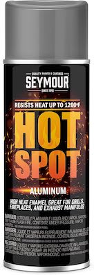

Q. I hope I'm posting this in the right place. I tried searching the archives for an answer to my question, but I get tons and tons of false positives having to do with how to coat stainless steel. I'm interested in finding out about stainless steel coatings (the one I'm looking at contains 316L stainless) that are intended to be applied over carbon steel, somewhat like "cold galvanizing."
My question is how effective these coatings are, and how difficult they are to apply. I'm interested in the stainless compounds because I need to protect mild steel that'll be exposed both to the elements (located outdoors) and to high temperatures (perhaps 1000 °F). Cold galvanizing -- and even hot dip galvanizing, for that matter -- won't tolerate the sorts of temperatures I'm dealing with. The stainless steel coatings are available with maximum temperatures up to 1200 °F, which should be enough -- but how much corrosion resistance do they provide? Can a hobbyist apply them easily in the back yard?
Hobbyist - Woodbridge, Virginia, USA
July 13, 2008
A. Hi, Matt. We named two products above. They are easy enough to apply since they come in spray cans like other paint. It's just that they include flakes of stainless steel.
My own feeling, though, is that decorative effect is a large part of their attraction because I don't understand why their corrosion performance would be expected to be superior to more conventional paint. Stainless steel does not offer cathodic protection to carbon steel like zinc galvanizing does.
Although I don't know the specifics of your application, my feeling is that a high temperature (1200 °F) aluminum paint ⇨
would generally be a better idea.
