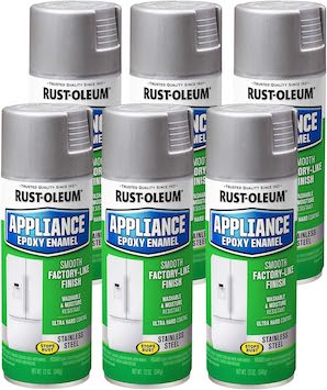

Stainless Steel Appliance Paint
stainless_steel_paint_fridge
A. Hi, Damian. Although I share Tom's concern, it may be worth a try. Amazon sells a major brand stainless steel spray paint made for this purpose .
A. There are several brands of stainless steel paint intended to offer the aesthetic look of stainless steel
If anyone has tried one, please update us.
Ed. update: Read on for several negative comments about the Rustoleum appliance enamel, mostly that it's a graphite color rather than shiny stainless color.

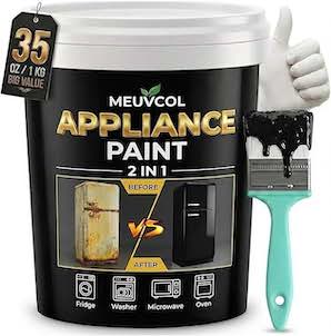

Brush-on Appliance Enamels
appliance_enamel-brushon
Q. I tried the stainless film but it won't stick on "pebbly" finished appliances like most fridges are nowadays. What's the next suggestion?
I, too, want a brushable appliance paint (in black) as our kitchen is upstairs. It's too difficult to get it downstairs to paint in the garage.
Elaine B [surname deleted for privacy by Editor]
- Lago Vista, Texas

Rustoleum Appliance Enamel
Hi. I am also interested in painting an old fridge with a stainless steel look and just wanted to pass on some info: Rust-Oleum makes a spray paint strictly for appliances, which comes in several colors (including stainless steel). I haven't tried it yet, but will update on the results when I do. The paint is called Appliance Epoxy on eBay or Amazon [affil link] and the stainless steel color is #7887.
Hope this helps!
Michelle F [surname deleted for privacy by Editor]
- Santa Rosa, California
Q. I just purchased the Rustoleum Appliance Epoxy on eBay or Amazon [affil link] (which was extremely difficult to get in my area. Who knew?) I am getting ready to paint my white dishwasher that has a plastic control panel which I am going to apply a plastic primer to before painting with the appliance paint. I was wondering if anyone had success using the Rustoleum appliance paint in their projects? I would appreciate any info or tips.
Jeannie H [surname deleted for privacy by Editor]
- Yorba Linda , California
thumbsdown Well, here is my follow-up. Over the weekend we painted our white dishwasher with the Rustoleum #7887 stainless steel appliance paint. My advice- Don't! It turned out with a very matte, dull finish nothing like the stainless steel fridge that I was trying to match. The color of the painted dishwasher appeared to be much darker than the real stainless, almost like a graphite color. Consequently, we have decided to purchase a new stainless steel dishwasher because the look was just too hodge podge.
Q. Question about the stainless steel appliance paint (Rustoleum 7887)...I have a fridge with a textured beige surface, and I think the matte finish would be best for that...did your fridge have a smooth finish? Thanks
Jon E [surname deleted for privacy by Editor]
- Catonsville, Maryland
A. Jon,
It was actually a dishwasher we painted and the top panel was a textured plastic and the bottom was a smooth metal. The paint job came out good on both surfaces as long as you are not looking for a shiny metal finish. I would recommend doing many coats some diagonally, horizontally and vertically and do it in a very ventilated area. The paint smell can be pretty overwhelming. Also go on the Rustoleum web site because the guy in the tech department (I think his name is John) is fantastic. They have an 800 number for tech support. Good luck.
thumbs down sign I just bought Rustoleum Specialty Paint stainless steel. It is new and I had a difficult time finding it. I painted the door of my dishwasher to match my new stove and it is too dark. It looks like graphite in color. I am contacting Rustoleum today to see if I can return it to the store for a refund. At $23.00 for less than a quart, I want my money back.
Louise Carter
- Revere, Massachusetts
March 5, 2009
Q. I saw the question, but never the answer. Will it look natural if you have the textured refrigerator surface? If not, can that be gotten rid of with a sandpaper? ⇦ Answer?
Sarah Ferris
- Surprise, Arizona
April 13, 2010
A. Hi, Sarah.
Jeannie H did answer her own question. Sorry, if it didn't quite answer your question.
Although I haven't done it, my bet is the stainless paint will look no better or worse on the textured finish than on a smooth finish. Good luck!
thumbs down signI bought the Rustoleum Specialty Stainless Steel paint, what a mistake.
I used the recommended rustoleum clear over the paint and it wrinkled.
Even if it would have turned out nice the color is a graphite look.
It might look good on a garbage can, or better yet toss it in.

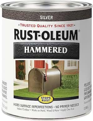

Hammered Silver Paint
paint_hammer_ag_rusto
A. OK, so I know this is going to sound a little "off"...we painted our fridge and dishwasher with Rustoleum silver hammered paint...it looks great! It's been over 2 months now, and no chipping.
Also, I used "Mop and Glow" floor wax on both and they are very shiny. I love the look, and our friends thought we had stainless appliances. We have a stainless microwave and oven, that are not next to either of these 2 painted appliances. A word of caution about the paint...it is very sticky (almost glue-ish). Use a roller, not a brush, and work quickly.
Mary Gold
- Scarborough, Maine
thumbs up sign Mary has it right with the use of Hammered Aluminium spray paint, I matched an apartment sized fridge & stove in my cabin using the Red Hammered Aluminium and the counter & breakfast bar using the Light Silver and it looks great!
Jaymes allen
- La Crosse, Wisconsin
May 26, 2010
A. Mary Gold,
Hmmm, it's interesting that you used Rustoleum silver hammered paint. I used the Rustoleum brown hammered paint on my bathroom faucets. They look like brushed nickel, very cool. I may pull my fridge out and try a sample area on the back corner using the silver. Never thought of that, thanks for mentioning your results!
Kellie Johnson
- Spring Hill, Tennessee
July 5, 2010
