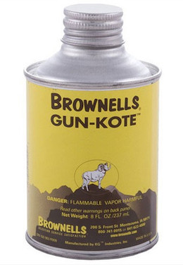

Q. Hello. Anyone can explain to me what is GUNKOTE?
kabz juezan
- dubai, uae
May 2, 2015
Brownells Gun-Kote
brownells_gun_kote
Hi Kabz. Where did you hear about that word and in what context please? My guess might be KG Gun-Kote offered by Brownells. It's an epoxy low friction bake-on coating available in a number of colors. Good luck.
