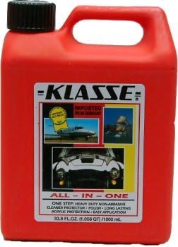

Product to sealclearcoat hard anodizing?
Klasse Glaze
klasseSealantGlaze
Q. Hello Finishing.com, does anyone have experience with a particular product (i.e. Klasse sealant glaze, ceramic glazings, etc.) that a hard anodized surface could benefit from?
Mainly looking to prevent color fade, shed water, extra protection from elements, etc., as these are brake calipers that are factory hard anodized. I know the HA surface is very durable but it's still not completely impervious to wear and tear.
Jason Peskin
Hobbyist - Half Moon Bay, California USA
April 4, 2020
A. Hi Jason. We changed your wording from "seal" to "clearcoat" because the word "seal" has a universally used & accepted meaning to anodizers and we don't want to muddy the water  🙂
A lacquer or clearcoat is not going to perform like hard anodizing, but if you are speaking of the visible non-wear surfaces, yes, you can apply a clear coat of your choice if you wish. We can't suggest specific brands or sources (why?), but readers are certainly welcome to comment on recommended types. Good luck.
