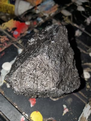

Q. I have a weird bluish silvery rock that is not real heavy and you can grab the rock immediately after heating with a torch and nonmagnetic but I can hook it up on line to a speaker and it will work and the pictures I have of it do not really show blue but when you look at it it is very apparent. ⇦ Answer?

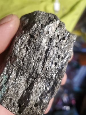

Q. Hi, I need help with identifying a rock I have found. I'm no rock expert by any means, just a weekend metal detector guy. I've found a sample that fits the description of all 3 and my local jewelers say they have no idea except it ain't gold or silver or aluminum. Can't seem to find any good pics online or anyone who can tell me how to test this thing. Would be glad to send some pics if needed. The best description I can give is that it is flat, silvery dark grey in color. & very heavy, it weighs in at 3.185 ounces.
Charles Helms
hobbyist - Riegelwood, North Carolina
A. Charles,
Why don't you go to a local Assayer ... presuming/hoping that you have one in your neck of the woods.
An 'assayer' is nothing more than a mining chemist ... but would have/should have all the testing equipment to determine what you sample might be.
... and if it's solid Platinum, please contact me IMMEDIATELY! I'd like to get some shares!

A. Look for a metallurgy lab around, they will analyze it for a decent price.
Guillermo Marrufo
Monterrey, NL, Mexico
A. It will cost you a good bit of money to have it analyzed by spectroscopic methods.
While anything is possible, I doubt if you found a "chunk" of any of the precious metals that you mentioned. If it is, I would be looking for more, before someone else finds it.
My guess is nickel or cobalt. Put a drop on pure nitric acid on the brightest spot. If it turns green it might be nickel. If it turns a blue or purple, it probably is cobalt.
You might put the whole rock or part of the rock in swimming pool acid to see what happens. Some kinds of rock dissolve and others do not. Some metals will dissolve and others will not. Save the solids in a vial and the acid in a plastic container for possible later analyses.

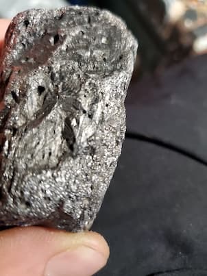

Q. I found a stone and/or nugget of what seems to be palladium-rhodium-platinum or meteorite or both -- I don't know. Looking for help on what to do with it ... I'm in desperate need of financial help. If you could point me to some place or person that would help, thank you very much.
palladium-rhodium-platinum? a palladium-rhodium-platinum? b
Jeremy Eads
Hobbyist - Birmingham, Alabama
April 11, 2022
A. It looks kinda like space nickel. I had some, it was heavy as hell like a metallic grey color. I took a grinder to it to see the cut-away and it was surprisingly soft and hard to really cut because the heat from the grinder kinda softens it. Anyway I gave a friend a piece ... he took it to a pawn shop and got 90 bucks a gram for it. I thought it was palladium, but just nickel from space that was somehow formed in an environment with no oxygen
Dee Snuts [ed. note: obviously a fictitious name]
- California
September 23, 2022
A. Hello Jeremy,
It's very hard to determine metal(s) from a photo. If you want to invest some cash and have it assayed, that would give you a concrete answer. As far as anyone getting $90 a gram for "space nickel" at a pawn shop, I'll be the next one on Jeff Bezos' rocket and have my net out.

Q. Could anyone Tell me what this is. ⇦ Answer?
mystery ore c   mystery ore a   mystery ore b
Bud
- Selma Oregon
November 22, 2022
? Hello, did you find any answer, I have the same ore. It is NOT affected by any acid, but with potassium chloride on eBay or Amazon [affil link] and ammonia on eBay or Amazon [affil link] it turns red. ⇦ Answer?
