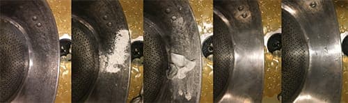

Dishwasher ruined shiny aluminum
     Dishwasher detergents are strongly alkaline (as is oven cleaner) and aluminum is not resistant to strong alkalies, so putting aluminum items into a dishwasher is likely to damage them.
     Scrubbing with cream of tartar on eBay or Amazon [affil link] seems the most reliable fix when dishwashers turn aluminum gray & spongey.

     Ketchup, lemon, & vinegar were partially successful, and there are reports of success with: metal polish, ammonium citrate, Glass Cooktop Cleaner, Barkeepers Friend, Silvo, and Brillo, The Pink Stuff on eBay or Amazon [affil link] , or avoiding the problem by switching to Mrs. Meyer dishwasher detergent. Feel free to add your method. Read on, join in ...

A. I was bummed to find my retro cake cover discolored from putting it in the dishwasher. Found the recommendations here and modified (can't help it, I'm a guy) some of the suggestions and results were spectacular.
I took damp paper towels folded X3, wrapped them around the cake cover; drizzled white vinegar ⇦ in bulk on eBay or Amazon [affil link] atop the cover to seep into paper towels then put it in plastic shopping bags to soak. Removed them and made a paste out of Barkeepers Friend on eBay or Amazon [affil link] and water and scrubbed some with a scrub sponge.
Cleaner than it's ever been. Still some slight telltale signs of discoloration but I'm a happy guy; my cake won't go stale.

A. Try Barkeepers Friend on eBay or Amazon [affil link] . I made a paste and rub most of the grey off easily. soaked in water with some of the barkeepers friend for about 10 minutes, grabbed a scotch brite pad and with very little effort in less than 2 minutes it was like new.

A. I read many of the responses, then combined all the knowledge gathered, along with what I had on hand, and discarding anything remotely dangerous, I came up with an amazing result. I tried it again & again with the same results.
aluminum sieve
My dishwashing disaster was a very old aluminum sieve that I loved. Here's what I did: I applied Barkeepers Friend on eBay or Amazon [affil link] , smeared it around with a folded wet paper towel, and let it sit for 5-10 minutes. Then I used the same wet paper towel to rub briskly back and forth over the area. I rinsed it well and the area was cleansed of the blackish mess! But it wasn't bright, as noted by others that had used that technique. But here's what I did differently: I topped it off with a very light rub of Brillo. Now it was shiny! And it didn't take hard and lengthy scrubbing/rubbing, and no scratches. (The scratches in my photos go back many years)

Immersion in Heated Cream of Tartar solution
A. I just tried all the above suggestions on a formerly shiny, now tarnished, aluminum bowl. Forget the glass top cleaner, the lemon & salt, the lemon, the vinegar ⇦ in bulk on eBay or Amazon [affil link] & baking soda.
After wasting 1 hr scrubbing, forget everything except: in a large pan add water & cream of tartar on eBay or Amazon [affil link] (I did about 2 T); heat to just below boiling; let pan/bowl/item sit until color changes to normal -- about 30 minutes. If you have a large bowl you will need to rotate it as the color changes. It's a lot easier than scrubbing for a long time.

I tried scotch-brute scrub, brillo scrub, cream of tartar in boiling water soak for 6 hours. Pot is brighter but remains dull and black smudges appear if I use a paper towel to wipe it. I'l try buffing next, but I can't easily buff the interior. Has anyone tried the ammonium citrate method suggested above (from Zagreb, Croatia) ??

A. My experience with Cascade Platinum on eBay or Amazon [affil link] is that it takes off the metal from utensils and pots & pans, and makes spoons black. I have no idea what causes this, but as far as a dishwasher detergent, it's the best out there and works exactly how they describe it. So keep the metal out and you will be okay.

A. Hi Richard. I have a Bosch dishwasher with stainless interior as well, but we don't put aluminum in the dishwasher; it's just a bad idea. Personally I don't think the stainless interior is the problem, but you may be on the right track with the water temperature. Maybe you can turn down the water heater as long as the clothes washer keeps working.
A. With more research and a bit of experimentation, the appearance of aluminum corrosion with a new dishwasher can likely be attributed to a combination of:
previous removal of phosphates (which had some protective effect) from dishwasher detergents;
the addition of more corrosive agents to detergents to make up for the missing phosphates;
the higher water temperature of the new dishwasher;
the higher concentration of detergent in a more water-efficient dishwasher;
and the longer contact time of the new dishwasher.
Switching from Cascade Platinum (15X) to plain old Cascade (10X) helps a good deal but does not eliminate corrosion. Aluminum-clad pots will have to endure it; the rest of the aluminum will be replaced with stainless steel.
