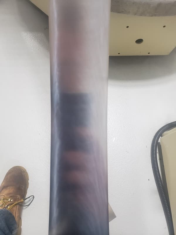

Strange look to defective nickel strike on stainless
Q. My name is Daniel and I'm a minster heavy press operator. Right now I'm running 302 SS with a .0005 nickel strike and something is definitely not right with this material. However, we can't figure out what it is. The plating supplier is saying that nothing is wrong with the plating bath -- I disagree.
2797-1
This is a picture of the material if anybody can identify the defect with the material that would be awesome. Thanks.
Daniel schaffer
- Delavan, Wisconsin, USA
May 5, 2020
A. Check your anodes and anode connections to make sure all of them are working properly. Secondly, look for anything that could cause a partial barrier or screen between your anodes and workpiece.
The pattern you show is very precise and regular in shape, so I suspect it is not a fault of the process, but your equipment having a physical defect
