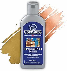

A. High end brass polishes containing benzotriazole form a very thin and durable copper complex surface layer (not an oil film) which keeps tarnish from forming for months indoors. The problem is to determine which contain the chemical (Goddards Long Term Brass & Copper Polish is one I know of).
Benzotriazole
can be purchased from photo supply houses, costs a bit ($17 for 100 grams). It can be used in a dilute alcohol solution as a wash applied after cleaning/polishing with cloth or spray to retard tarnishing. Anhydrous denatured alcohol can be found at hardware or paint stores. The article can then be waxed or lacquered for greater durability.
