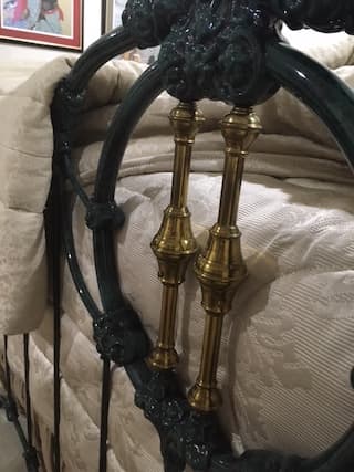

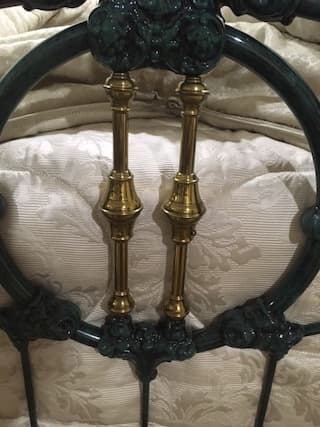

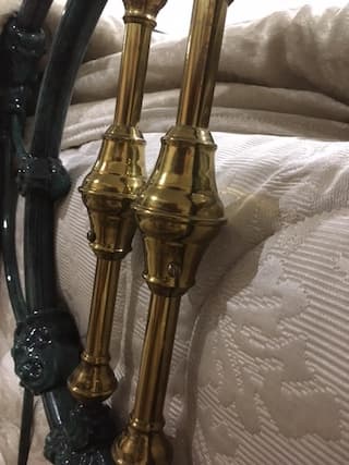

Q. Trying to figure out how to remove the brass spindles on an iron bed.
There is a screw in the middle part of each brass spindle. I have tried removing the screws but that seems to just allow the middle piece that the screw is located in to move.
I want to polish the brass and give it a lacquer coating.
Thanks for any help.

A. There is a bolt that goes through the bottom rail into each spindle. Remove that first, then gently unscrew the spindle from the top rail. It has a blind "L" bolt that you can wiggle out once the spindle is out. The key to the replacement is there is a nut crimped into each end of the spindle. Good luck
