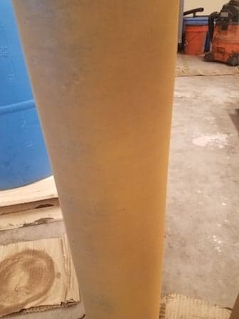

Zinc phosphate coating is covered with rust
February 14, 2019
Q. Hello, all.
I posted on here mid-2018 about our phosphate line.
Since then my employer has overhauled the line and gotten a new chemical supplier (Dubois).
Our new line was running 80 ksi steel well for a few days.
Now our results are covered in a veneer of rust.
14221-1d   14221-1c   14221-1b   14221-1e   14221-1a
Our line is set up as follows:
Unikleen
Rinse
Rust remover
Rinse
Pretreatment
Phosphate
Rinse
Oil
TA 44.8
FA 7.4
Ratio 6.054
Iron 2.65%
Eric Winters [returning]
Line operator - Round rock, Texas
A. Dear Mr. Eric, please go through the detailed answer given by Mr.Rodger Bridger. You will find the exact solution (Topic 10242)
Avinash Vidhate
- Nashik, Mahatashtra, INDIA
February 17, 2019
A. Eric,
When in the process do you notice the rust? Is any seen between acid and phosphate, phosphate and oil, or is it all after the oil? Is this a manual line/do you have long dwell times between stage? Second what are the TA/FA/R/Fe parameters called out on the data sheet?
Follow up on these questions and I can try to get you back on track.
Jameson Grout
- Agawam, Massachusetts
February 18, 2019
