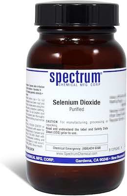

Selenium Dioxide
selenium dioxide
A. Selenium dioxide is a fantastic chemical for blackening copper and brass. In fact, it is the chemical trophy engravers use on a laminated brass plaque to make the lettering black (the lettering cuts through the lacquer). It's totally jet black and very hard. The product they use is called Gravoxide or oxidizer.
It's more readily available in Birchwood-Casey Gun Bluing on eBay or Amazon [affil link] . It's advertised as a blue/black oxide finish for steel but it is very effective on brass/copper. Brasso on eBay or Amazon [affil link] polish does not readily remove this finish.
I'd recommend an acid pickle to remove existing oxide or whatever method you have to get the metal very, very clean first.

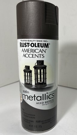

Q. I have a chandelier made of steel and tubular steel and painted in a pewter color (cold grey/blue tones) with a highly lacquered finish. I'd like to change the finish to bronze (warmer tones) and I have some professionals telling me that it cannot be done over the high lacquer. Do you have any suggestions? Would auto paint cover? It is a detailed fixture and cannot be sandblasted b/c of the wiring.
I appreciate any suggestions.
Lisa Gold
homeowner - Orange, Connecticut
March 18, 2011
Rust-Oleum Oil Rubbed Bronze
rustoleum_ORB
A. Hi, Lisa.
Simplest, easiest, cheapest would be the Wax Rub Rub'N'Buff [affil link] , so I'd try that first. If not, you can try removing the lacquer with lacquer thinner on eBay or Amazon [affil link] Flammable! . If that doesn't work you can remove it with the far more powerful Aircraft Stripper, but only outside with good ventilation (not in place), and then blacken. Or you can use one of the fancy paints like American Accents
