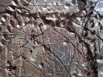

I'm an art fabricator - realising sculptures for artists. Over the last 8 years I developed a workshop in electroforming. Being educated as a foundry technician in an art-foundry I worked with many techniques and metals before I started this quite large "experiment". But sometimes I realise that I miss a basic education in the field of plating. As well all the books I have give answers, but often to specific problems - just some wage hints.
electroformed copper art 0085-1a  electroformed copper art 0085-1b  electroformed copper art 0085-1c  electroformed copper art 0085-1d  electroformed copper art 0085-1e  electroformed copper art 0085-1f
This is the setup we work with:
We have view acid sour copper tubs, from small to bigger scale (1100gallons). The largest piece we made in one piece was 7.3 by 6.2 ft. (230cm x 190 cm)
Most of the works we did by now where canvas like objects, 4 x 4 ft times 1.5 inches deep. We silver the the surface of the rubber moulds to make them conducting.
We use Enthone additives, work with filters the electrolyte is thermo controlled around 82 °F. Our normal deposit is around 0.08 inches of copper, forming with about 350A. We normally working with about 20 A/feet2 (2A/dm2)
Now we do have some problems and some things we never really found the answers for. Therefore I'd like to try to get some answers here.
1. we used to have more or less tension-free copper. Lately we experience our electroformed "panels" to have a concave or convex "stomach". As there would be too much surface material. We made several tests with straight flat objects like glass. The copper on the "mould" it looks fine and straight, when we de-mould the copper, it bends.
We didn't always experience that. The analysis are fine (content of copper, sulfuric acid, chloride and additives)
Does someone knows this problem? or maybe a solution for it?
2. we have sharp 90° angles in the mould (the edge of the panels) and by nature the edges are very thin and weak. Even more the corners.
Is plating with lower or higher currents better for this edges? Or would an alternating rectifier create a more even deposit in the edges and corners?
3. welding of electroformed copper is almost impossible (as I understand because of the hydrogen in the structure) is there a treatment to solve this problem?

Q. Hello. I make electroformed jewelry and I make my solution myself. Everything was going smooth till last night. I left the rectifier open on a low current to plate a pendant in a 1L solution. Current was about 0.2 amps and voltage was about 0.3 I think. In the morning most of the piece was plated the way I want but a small part of it was left above the solution (I don't know how but it evaporated more then usual I think).
And the part left outside looked like it was plated a thick layer of textured copper but when I touched it, It just crumbled. Not even crumbled, it was all squishy. Then I electroformed one more piece and same thing happened to the whole pendant. Why do you think it happened? Can someone help me please?

"Trouble in Your Tank: Handbook for Solving plating Problems"
by Larry Durney
durneyT
A. Hi Cagin. When you go from satisfactory plating, to unsatisfactory, keep in mind Larry Durney's 'Logic of Troubleshooting':
"We can safely assume that a working system cannot become a non-working system without some change occurring"
In this case I think you're already 99% confident about what changed: the solution composition -- perhaps due to evaporation, extended run time, or something else. But you've not yet given us any information on that subject. Although it would be nice if people could tell us how to solve the problem of squishy plating from solutions of unknown composition, I don't think that's likely to happen. Get back to us please.
A. Probably too low amount of copper. Maybe iron in solution can be cause too. Try fresh solution. Hope it helps and good luck!
