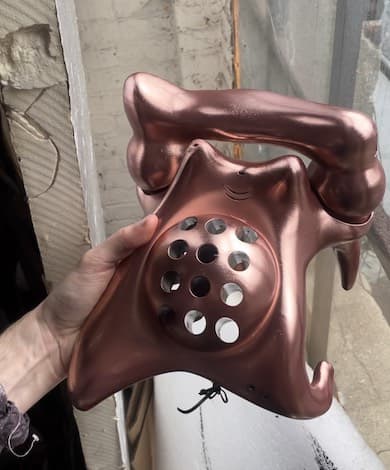

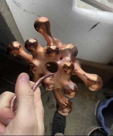

Q. Recently all of the things I have been electroforming have been coming out this reddish copper color. I understand that when there is not enough current the result is a dull salmon color , but this is a little different. The object is still shiny it's just more red. It looks much different than other times that I have had too little amps on my object.
Any ideas to why this might be happening? For context I have a massive 150L tank that I use for all sorts of materials and sculptures. We electroform onto 3D printed plastics all the way to literal garbage -- not very clean but I do have a flo-king filtration system for particulates.
Attached are photos of the reddish color (shiny) and then another photo of a normal object that is shiny and the typical copper color. Both taken in similar lighting --
0085-8a   0085-8b
Does anyone know any scientific basis for why there is color variation based on the amps? I understand that the shiny ness comes from a smoother surface from a more steady and level plating, but why is there a difference in hue?
Sebastian Bidegain
- New York
December 28, 2023
A. Hello Sebastian, you could be co-depositing some unwanted metallics in the bath. Your copper bath supplier should be able to do a full analysis on the bath that includes suspect metal concentrations. Iron is a big one to watch. You can also dummy plate the bath at low current densities. Watch the temperature during plating as well. As far as color change caused by different amperage, there must be a problem either with the solution, rectifier, or other parameters for the process.
