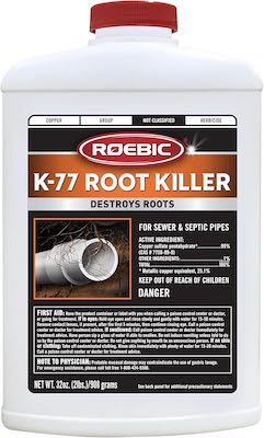

Now if you're game, try this … it works beautifully. Buy K-77 Root Killer ⇦ on
. Mix one lb. to one gallon distilled water, bath temp approx. 75 degrees. Purchase a paint product from your local dealer of bright copper, metallic spray paint (not the real cheapo). Clean your substrate then spray it good. Allow one hour to dry then plate as usual. Man it comes out salmon pink.
Good luck,

It may be against Federal law to use root killer in a way not in accordance with the indications for use as a root killer. Does anyone know what this stuff is, chemically?
Proprietary products rarely tell you what they are 100%, because then everyone could copy them and claim them to be identical and all their development and marketing efforts wasted, but most root killer is essentially copper sulphate pentahydrate. Yes, there may be some contaminants that could be non-ideal for plating applications. Be beware that some root killers like RootX are NOT copper sulphate.
The composition of K77 root Killer is > 99% Copper sulphate. Here is the Cornell University site for the Material Safety Data Sheet:
http://msds.pdc.cornell.edu/msds/msdsdod/a246/m122546.htm#Section2

Q. I am a 'classic car 'restorer, and one of my biggest headaches is the quality of commercial electroplating work, It is simply not possible, here in the UK, to find any electroplating shop that is willing to spend the required time, and degree of care and understanding necessary when dealing with unique, irreplaceable auto parts.
I have attempted my own dull nickel plating process, with far better end results than any plating shop has ever produced for me, and I would like to try my own duplex chrome plating. This naturally entails an acid copper system (I would use nickel as a strike coat) Proprietary solutions are very expensive compared to commercially available forms of copper sulphate crystals, but I have read, in an item on this website, that there is more to a good acid copper solution than simple copper sulphate and sulfuric acid.
Is this important, given that it is only a 'base coat' for a further two coats of nickel, before the chrome?
Apart from this, is 'agricultural' copper sulphate, i.e., weed killer, too impure to use as the basis for electroplating solution? Any help is greatly appreciated.

A. Hi, Michael. The purpose of the copper plating (in this case) is to be soft and buffable; most people probably consider "show chrome" to mean highly buffed copper plating under the nickel. But if you are not planning to buff the copper to a mirror shine, I think you'd be better off leaving out the copper plating, and just starting directly with nickel -- that's what most OEMs have done for many years now.
Electroplating shops do not make their copper plating processes from root killer, although they use a great deal of copper sulphate and thus have the potential for saving a lot. If you want to do better work than they, I can't really see using root killer, but only very pure products.
Try to borrow or buy a cheap copy of the Metal Finishing Guidebook or the
Canning Handbook to see the principal differences between professional acid copper plating solutions and root killer, and to what extent they are or aren't important to you in your particular situation.

And speaking of root killer and MSDS, I did some research and found the datasheet for K-77 Root Killer on the website of the manufacturer, Roebic, here www.roebic.com/pdf/K-77RootKillerMSDS.pdf
It is, in fact, >99% pure Copper(II) sulphate Pentahydrate - the same purity as the LR (low resistivity) grade CuSO4·5H2O that is, according to my further research, commonly used in electroplating applications. Furthermore, I've found nothing anywhere that would indicate that K-77 is any more restricted in legal use than copper sulphate under any other brand, which makes sense - it is no different and includes no other chemicals, and is mostly environmentally safe (disposal via plumbing is ok, dumping in lakes and rivers discouraged but ok in small amounts) except in amounts or concentrations significantly greater than you'll find at Home Depot.
But yes, proprietary solutions do consist of more than copper sulphate and sulfuric acid. they usually also add small (very small) amounts of HCl, because chlorides at 30-100 ppm (depending on the rest of the solution) helps brighten the plating. So does the brightener, usually the main or only proprietary component that I've seen in professional solutions. For an example of the chemical composition of a brightener, check out this patent www.freepatentsonline.com/3715289.html
So, it might be easier just to buy some other company's - in my case anyway, that's where my tinkering with chemistry gives way to my wallet. Expensive, likely. Necessary? The professionals will always tell you yes. It's just my opinion as a casual idiot, but I've seen a few people achieve great results without it.

K-77 may well be a root killer that is 99%+ copper sulphate as you say, but you've illustrated the hazard of the procedure perfectly because if others instead select RootX, for example, they get a herbicide with NO copper sulphate.
