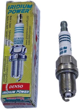

Iridium Copper
Iridium Spark Plugs
iridium_spark_plug
