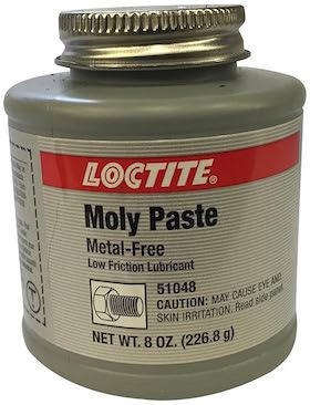

Moly Anti-Seize Compound
moly_anti-seize
A. Hi Jeffrey. Bicycle shops have spray cans of teflon, as this is the lubricant of choice for bicycle chains. Auto stores may have it. You can also order Molybdenum Spray [affil link], but qualifying to a particular MIL spec might be something else.

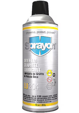

LU204 Graphite
Dry Film Lubricant
lu204_dri-film_spray
Q. What ASTM or MIL spec would LU204 fall under?
Thank You.
Charles Thurber
machining - Thousand Oaks, California USA
May 6, 2016
A. Hi Charles. This is a dry graphite spray, and MIL-L-24131 [link on DLA] covers dry graphite sprays, but I'm wouldn't know if LU204 can or can't comply. Could you please try to explain your situation that motivates this question? Thanks.
