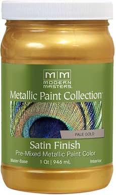

A. There's a multi-step painting process by modern masters called metal effects that can be used on exterior metal roofing. I think it's a little pricey if I remember correctly, but it looks really nice. There are a few different finishes available....aged iron, copper patina, etc. hope this helps
It's a 4 step process....a coat of seal over the steel, then a coat of metallized paint that matches the steel over that, then a coat of rust activator (which supposed oxidizes in minutes) and then another coat of seal over that....you can read more about it at the modern masters website under metallic effects. There's also an image gallery with some examples of rust effects used on exteriors.
