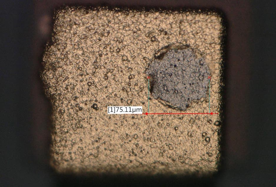

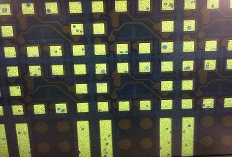

Q. Hi Guys, we are doing soft gold for substrate application and are facing gold peel off. We are doing soft gold plating on nickel surface. The Gold Plating peels off randomly from the Nickel Surface, almost all peel off areas are circular, the peel off is detectible after few days of plating. Nickel surface in peeled areas shows Fluoride in SEM/EDX. Nickel bath shows high C content >3000 ppm, with AAS
analysis along with 3 ppm of Fluoride. So far we have not been able to find the source for the contamination in Nickel bath (Fluoride, C).
Is the peel off related to impurities in Nickel bath, if yes what could be the source of contamination? can it be city water supply?

A. Hi Iqbal. Nickel plating baths usually operate at 140 °F (60 °C) so, over time, they accumulate and concentrate the impurities in city water. DI water is a safer bet.
But regardless of AAS or SEM/EDX findings, the first step is to observe whether the process is being run properly. As you can see from this thread, passivation of the nickel from too long a delay before gold plating, or excessive brighteners in the nickel bath are common causes of the gold peeling from the nickel.
Is this rack, barrel, or strip plating? I was once involved with a problem of gold plating peeling which was caused by excessive barrel rotation speed -- the parts were spending too much time fluttering down from the top of the barrel while the nickel was busy passivating itself.

But maybe you were on the right track being concerned about fluoride. And since you note that the peeled areas are circular, I wonder if there is any possibility that your maintenance department is using a teflon lubricant, a tiny mist droplet of which might fall into one of those tanks, disperse into a circle and float on the surface? When something has a particular shape rather than random shapes, there may be a physical principle driving that shape. Sorry I can't help further.

A. Hi Iqbal. Sorry, but when you said the plating was peeling off in circular shape I did not envision anything anywhere near as small as a gas pit. If photos are available they would probably help.
But if the peel-off is gas pit size, I think you should try to pull a part off the rack after nickel plating but before gold plating and see if in fact there are any gas pits present. Good luck.

thumbs up sign  Dear Ted, Please find below the picture of gold peel-off, the diameter of the circular shapes is up to 75 micrometers
6736-1a   6736-1b
Regarding your advice on checking the board surface, just before entering the gold tank. I will let you know as soon as I have some feedback from my production team.

A. Hi Iqbal. I can't claim experience in any similar problems, but the micrograph sure does look like a filled gas pit  🙂
Gas pits in the nickel plating will be shiny hemispheres of somewhat varying sizes. They are not from an air agitation system but from generation of hydrogen at the plated surface. They are solved with wetting agents and better agitation (including air agitation). Good luck.
