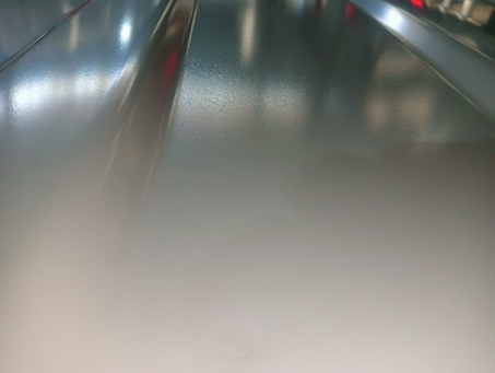

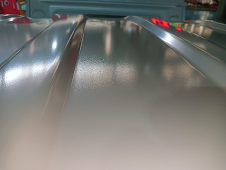

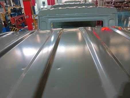

Q. I am currently facing an issue of CED rupture and pinholes in my coating process. I have checked and confirmed that all my bath parameters are within the recommended limits. Additionally, I am using an SCR rectifier with a 14 anode cell at 360 volts only, but the rupture and pinhole defects are still occurring.
jayeshemployee - pune
September 20, 2025
? How did you decide that you have a voltage rupture problem ?
Please share a photo of the pinhole problem.
- Nashik, Maharashtra
Ed. note: Please attach photos in email to <pics for posting>
(pics posted 12/5/25)
