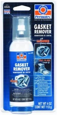

I have a powder coated aluminium part that I would like to polish. What is the best way to strip the powder coat given that I want to polish this piece when done?
hobbyist - Highland, Utah, USA
A. Utilize "Gasket Remover". Spray it on and after about 15 minutes you should be able to scrape it off with a putty knife.
Robert MarstersGovernment contractor - Chula vista, California, USA
