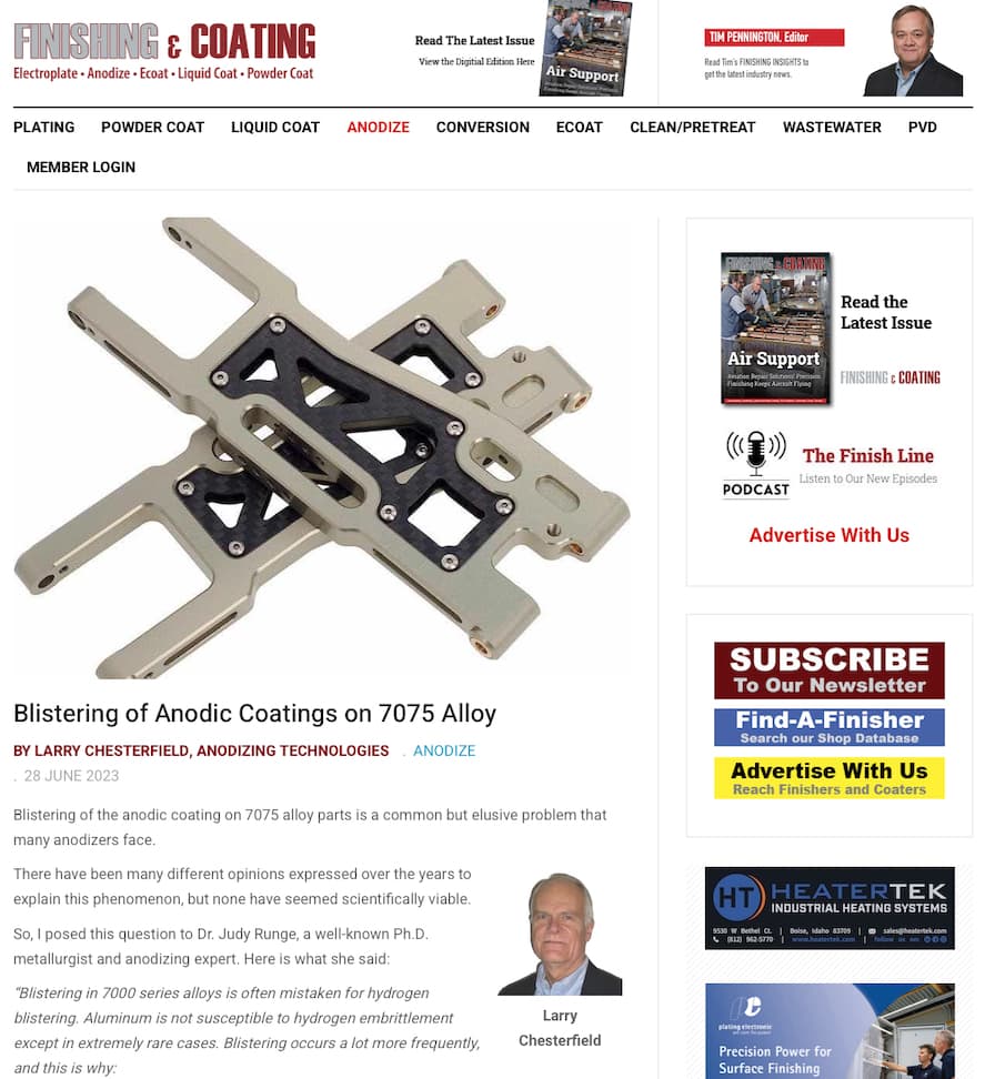

A. We had seen this problem years ago & then I found an article describing the problem. It was in August 2000 issue of "Products Finishing" & it is titled "Anodic Coating Blisters on 7075"
We eliminated the problem by reducing time in all tanks to a minimum - especially the black dye.
David A. Kraft
- Long Island City, New York
Ed. note: That article also stresses the value of a very very slow ramp rate because it can lessen the havoc the zinc atoms cause.

A. Hi again.
Earlier on in the thread a technical article in Products Finishing was referenced and linked to. For me the most important take-away was the claim/theory that such problems have to do with the way the zinc content reacts early on during the anodizing process, and that problems can be greatly reduced by a very slow ramp rate -- rather than anodizing at constant current, try anodizing by voltage, raising it only very very slowly. Feedback appreciated!
