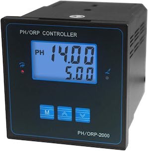

Q. My facility has been having trouble destroying Cyanide in our two stage system. We have been keeping the first stage at a pH between 10.5 and 11.0, but have not been able to get the ORP above +200 mV. There are a lot of metals in the influent that the Cyanide can complex with in the solution. There is cadmium and chromium for certain and ferrous sulphate is used in our processes as well.
The second stage is at a pH of 8.5 and we are having trouble controlling the ORP there as well.
Is there another way, other than addition of bleach, that will help us control our ORP readings better. We have been fighting with this Cyanide for some time now.

A. Your ORP readings are probably wrong. More importantly, is free chlorine present (by PAO titration or KI-starch indicator paper)? See threads #125/31 & 403/94.
Also, is your hypochlorite dosing sufficient, e.g., 7.5 lbs of NaOCl per lb of CN? https://www.nmfrc.org/bluebook/sec623.htm

A. First step - calibrate the ORP probe.
A little quinhydrone in pH 4 buffer ought to give you 264 mV; in pH 7 buffer, 84 mV.
What's your pH in that first cyanide destruct chamber? You could also try calibrating that sensor, and double checking the measurement with a handheld. The high pH conditions in a cyanide destruct unit aren't kindly to probes at all.

Q. The ORP probes are reading the standards correctly, and the KI paper is changing to a blue.
Is there a good way to make sure the probes are working, because these probes are new. The old probes were acting the same way. ⇦ Answer?

A. Other materials in the waste stream can affect the ORP. The important thing is that the cyanide and cyanate are destroyed. If the starch paper is purplish, indicating an excess of chlorine, and analysis shows effective destruction at the ORP you are getting, the ORP does not necessarily have to be an exact book value.
