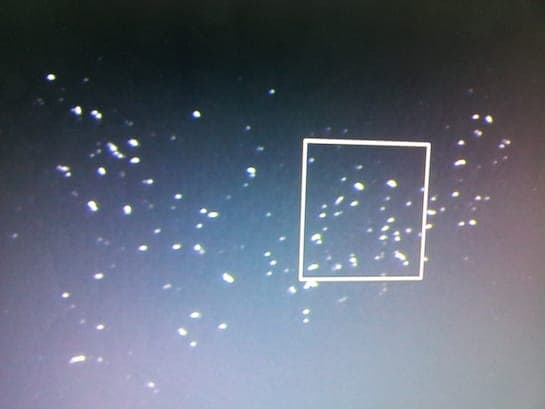

White specks defect on brass base nickel-chrome plating
Q. Hi everyone,
I have trouble about nickel - chrome plating process. On product surface, has 1 mm square visible white specks (about 100 specks). I do not know cause and improve it. Please assist!
Thanks in advance!
Phong Thai
metallurgist - BinhDinh, Vietnam
February 26, 2016
