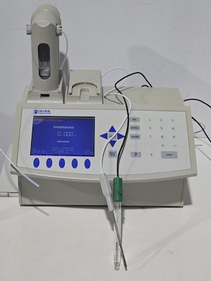

Q. We have been using a semi-automated titration system for our daily measurements. The system requires a daily pH calibration using 1.68, 4.01, 7.00, 10.01 and 12.45 standards.
We then transfer these values to an Excel spreadsheet for tracking the solution and making well informed solution adjustments. We have had great success with all of the titrations except for the Nitric Acid in solution of the DEOX chemistry.
Our DEOX target is 96 g/L of (Fisher Scientific Nitric Acid 65-70%)in solution
Our test process is:
Pipette a 2 mL sample
Add DI water up to 100 mL
Auto Titrate with sodium hydroxide
Press 'Start' Titrator will titrate to pH 3.7 endpoint. Results will be displayed as g/L nitric acid.
This nitric acid titration is very difficult to get a normal looking graph over time. The graph is very noisy.
I have conducted testing of the same process tank DEOX chemistry. Duration of all five samplings 30 minutes.
The first titration sample was extracted using a drum thief sampling the cross section of the tank without stirring the tank.
The result of the first titration was done using this sample.
Titration # TI00664 = 85.167 g/L
A second sample was taken and the extraction method was the same, no stirring and the drum thief was used.
Three consecutive titrations were run using this sample.
Titration # TI00665 = 88.088 g/L
Titration # TI00666 = 87.118 g/L
Titration # TI00667 = 87.533 g/L
The average of these three titrations was 87.579 g/L and % of deviation between the three samples was 0.5%
A third sample was taken and the extraction method was the same, no stirring and the drum thief was used.
One titration was done using this sample.
Titration # TI00668 = 86.601 g/L
My take away from this exercise was the three consecutive titrations of the same sample were showing repeatability of the semi-automated titration system.
The sampling method showed greater variation pointing to the chemisty not being homogeneous. I have since started stirring the DEOX tank using a stainless steel mixing paddle every morning. Then wait 15 minutes and take my sample using the drum thief.
I have not been tracking my results long enough but the graph looks less noisy.
I then spoke to the manufacturer in regards to this and I was pointed back to the manual titration using the bromocresol green
eBay &
indicator method.
I would like to understand the sampling methods of others out in the field. Should I go back to manual titrations?
What is the best method for day to day sampling? Use a dipper, drum thief or other method?
The first graph is of the proprietary chemistry in solution. It is easy to see how tracking and making adds is intuitive.
The second graph is what I was seeing when measuring the Nitric Acid.
Thank you All
Kurt Krueger- Lexington, Massachusetts
October 16, 2018
A. Hi again Kurt!
I read your post with a bit of a smile... You're going to drive yourself nuts over your DeOx! :)
Please don't! No doubt you've allowed yourself a pair of working ranges (target +/- some amount recommended by the manufacturer or your own experience, and then a narrower range like a warning limit) and your most simple, basic, goal for accuracy of the titration is to make sure that your titration error won't ever be enough to make you THINK you're in shop range when you're not, and that your adds will be accurate.
Your titrator sounds pretty repeatable especially considering the small aliquot being tested; I'm impressed. Usually smaller samples mean more analytical error, and 0.5% is outstanding.
Don't sweat the 'noise' TOO much in your samples over time. It happens. Reduction, rather than elimination, of the noise is about the best you can ask for. There's a lot going on, chemically, in a DeOx tank, and every new load of parts dropping off a new load of smut is going to slightly (even imperceptibly) shift how a free acid titration presents at that moment- It's larger trends over time that matter, and I totally get how you'd like to see your Nitric results looking more like your first graph. It's a chemical crockpot in there and you are correct that a reduction in noise may be achieved by ideal sampling.
To answer your question about sampling- you mentioned you swirl the tank with a paddle? Do you really not have a mixer in that tank (sparge, rotary, or recirculating)? If the tank is mixed well enough to function correctly, a dipper right from a few inches below the surface is absolutely fine. Rinse the dipper in the DeOx and dump it out a couple times before taking the sample.
The takeaway is don't get too crazy chasing perfection in a DeOx tank of all places, and you really want to make sure your tank is well mixed both at time of drawing test samples and time of use for best results with both!
Rachel Mackintosh

Q. Kurt,
Could you please provide more information on your semi-automated titrator setup? We are currently looking into getting one ourselves and have been having trouble finding the right balance between efficiency and cost. Any help is greatly appreciated.
Zander
- Denver Colorado
September 29, 2022
A. Good Afternoon Zander
We found the Hanna Instruments HI 902 semi-automated titration system (Now replaced by the HI932) to suit our needs. This system provided the accuracy, consistency between technicians(in comparison to a manual titrator results between technicians)and time to get results. All of the results are the saved and the results are transferred to a spreadsheet where we track/graph the titration results . We run this testing 3 times a week for the 5 separate titrations required for Chem Film process.
1.) Cleaner/Degreaser concentration in % by volume to water
2.) Deox grams/liter of nitric acid = (ml titration value)
3.) Deox grams/liter of Deox Concentrate = (ml titration value)
4.) Hexavalent Chrome Solution mg/ml
5.) pH of Hexavalent Chrome
All our Chem film titrations are completed in an average of one hour.
Hope this helps.
Cheers
- Lexington Massachusetts.
