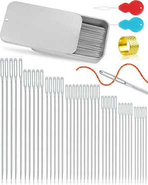

Nickel-free Sewing Needles
Stainless Steel
Sewing Needles
sewing_needles_sst
Q. My girlfriend has a nickel allergy and does costume construction, does not anyone know a place where you can get nickel-free needles? ⇦ Answer?
Tom
Thomas Wratten
- Brighton, Sussex, United Kingdom
Ed. note: Up above we listed 5 suppliers specializing in nickel-free items. One of them might offer nickel-free sewing needles. But stainless steel needles are available
Most stainless steel contains no nickel, but if it does it's usually considered non-leachable.
