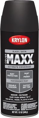

Covermaxx Matte Black
paint_covermaxx
Q. Can you recommend a primer suitable to prime cast aluminum? I have the same problem with my cast aluminum patio furniture, 2" areas of lifting paint. Does it have to be epoxy based primer? I want a super matte finish similar to Krylon Covermaxx super matte primer. After using an appropriate primer on aluminum, can I use this primer (for its finish look) even though it is a black primer?.
Also, can you list the step by step process for preparing the piece for priming and painting.

A. Hi Nikki.
We can't post recommendations for one particular brand over another (why?) but here's a link to a primer made for aluminum and galvanized surfaces which should be fine .
Primer for Aluminum
and Galvanized Metal
primer_for_galv
As previously mentioned, if you have loose paint you must scrape or wire brush it off first. Then, for best results, surfaces should be cleaned before painting. A scrub brush on eBay or Amazon [affil link] and a pail of Spic and Span on eBay or Amazon [affil link] or similar should be fine. Then hose it down, let dry, and prime. Good luck.
