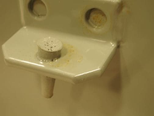

Q. I don't have pictures of the pitting issue along formed edges, however those pictures show the issue around welds and punched holes.
35126-1  35126-2  35126-3
As I mentioned, this issue appears on painted CRS and a few aluminum painted parts as well, though not as frequently. And because occurrence is so inconsistent, it really hard to pin-point the root cause.
I'd be happy to provide more information to assist in resolving this matter. Any input you can provide would be greatly appreciated.

A. This looks very much like a case of surplus anti-spatter from the weld process.
Take two identical components and wipe one thoroughly with MEK.
Run both through your system together and see what I expect to be a remarkable difference.

A. After seeing the photos, I would try putting a few drops of phenolphthalein on eBay & Amazon [affil link] on the areas to see if your getting bleedout from the bracket. If there is oil or any alkalinity remaining on the surface, the phenolphthalein should turn it pinkish.

A. I would go along with Williams analysis. The defect seems to indicate droplets are in a pattern of a sprayed on substance... in this case anti-spatter aerosol fluid.

Q. Bill and Terry - Thank you both for your replies. Our welder informed me anti-splatter is not used for TIG welding. Furthermore, this "pitting" appears where no welding occurs, as in the case of these pictures (around the half-shears, and plugged threads). And though I don't have pictures to illustrate, I have also seen it occur on formed corners of parts containing no weld at all, thus indicating this issue pertains to our wash line or paint process.
Bob - I'm not familiar with phenolphthalein on eBay & Amazon [affil link] . Should this chemical be applied on the surface of the painted part after "pitting" becomes apparent?

A. Phenolphthalein is an indicator used in titrating pretreatment chemistries. Almost all chemical companies have this readily and you can purchase it at any of the online chemical distribution websites. Generally speaking, it will turn pinkish in color when it is placed on alkaline organics. Phenolphthalein alkalinity is present only when free carbon dioxide (CO2) is absent and therefore exists only when the pH exceeds 8.3.
Most alkaline residues are caused by poor rinsing after washing with an alkaline detergent, but sometimes they are caused by alkaline water supplies. The latter case can easily be verified by checking the pH of the raw water. If it is over 9, the cause may very well be the water.
Many organics (oils, cutting fluids, etcetera)and soils that are being cleaned off in the pretreatment system are alkaline. So, if you put a few drops of phenolphthalein on eBay & Amazon [affil link] on this area AFTER it has been washed and BEFORE it is painted, you might be able to see whether the wash is cleaning the substrate properly. No color should show if it has been cleaned properly. If it turns pink, there has been a reaction and there's still an alkaline substance on the part. This type of test is not science and should be merely used as a starting point in finding the problem but sometimes you get lucky.

A. Well,
I can only state with certainty from observing the pictures that you have a problem with organic contaminants (oil, grease et al)
Your rinses are acting as contaminating bodies.
Perhaps they are carrying forward organic contaminants?
A reasonable fresh water rinse might be about 100 micro siemens .
An acceptable final rinse would be zero micro siemens resulting in a tested water run off of final rinse at about 25 or less.
So there is definitely a rinse problem.
An earlier reply suggested looking at your air supply quality.
That is also very valid.
I guess you have to investigate where the oil & or grease is entering your system.
There is no doubt that is the problem.

A. This problem is common to powdercoating and galvanizing, and in my opinion is what's sometimes called acid weep.
In both pictured cases you have an unwelded joint where one piece of metal overlaps the other, forming a small cavity.
This traps pretreatment chemical and is not easily rinsed.
The chemical boils out in curing oven, staining the work.

thumbs up signAfter 5 tries at powder coating, the powder coater gave up on it. I applied an epoxy primer/filler, patched the pits with Bondo on eBay or Amazon [affil link] , sanded the horse and painted it with a polyurethane paint and finished it with 6 coats of clear.
35126-5a  35126-5b  35126-5c
I think it came out looking good. Thanks to all of you for your comments.

"Good" is an understatement. Wow, it's beautiful.
