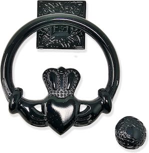

Q. My friends have a solid brass Claddagh door knocker for their new house. However, all the other door hardware is an oil rub bronze finish. Is an oil rub bronze finish available to spray or hand finish the knocker to match?
Joyce J. Shea
consumer – Magnolia, Massachusetts
A. To my eye, oil rubbed bronze is a brown-black finish with copper-ish or brass-ish tones showing through at the corners and wear areas. The brass can be generated with brass darkening solution
on
Amazon [affil link] or liver of sulfur, and can be relieved back to brass color at the corners and wear areas with ultrafine steel wool
on
Amazon [affil link] . It should be close — but such relieving requires some artistry skill.

Q. This is a two part question:
First, I have a customer who keeps referring to the coating they want on a brass piece as “oil rubbed bronze”. But what they actually are looking for is really blackened. I’ve done patinas in the past but never got it as black as their sample piece. Is there a way to get these pieces black?
Second part is the same job, different project. I have some railing posts that need to be made from steel (structurally required) but the owner/architect wants that same ORB/blackened bronze look. Outside of paint and powder, is there a product you can recommend to do this if it even is possible?

A. Hi Keith. Trophy engravers get that jet black color on brass with selenium dioxide; I don’t know if it works on copper, but suspect that it will.
It is certainly possible to do a heavy copper plate, then blacken, then clear coat steel railing posts, but usually such processes are done in a plating shop rather than in the field — and the cost might be prohibitive.
A. Keith, liver of sulfur sprayed onto heated brass will turn black. Also, you can rust steel with cupric chloride then spray brown tinted lacquer over result and looks just like ORBronze
