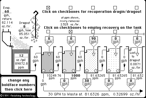

The rinses are highly important.
The CASCADE rinses after each step.
On the third rinse put an ion exchange resin.

P.S.: Ted, do you remember that I bought from you a great application for rinse calculations? It still works. February 2021 A. Very happy to hear that, Sara. I'm too lazy and busy to port it into a smartphone app, but maybe some partner will some day :-) Luck & Regards, ![]() Ted Mooney, P.E. RET Striving to live Aloha finishing.com - Pine Beach, New Jersey Need quick confidential answers? $25 Need project assistance? $100/hr. |
