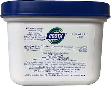

I have tried plating silver onto a penny but with no success. The penny effervesced a lot and the silver was covered with bubbles and occasionally let one float to the surface. I only let the two sit in there for about 10-20 minutes and nothing happened. I charged them with a battery charger ⇦ on eBay or Amazon [affil link] on 6 volts, the silver positively and the copper negatively. You should know that I did attach them to the wire that connects to the positive/negative chargers with clamps and they dipped into the sokution (weed killer). After a while, these clamps corroded. Also, I was concerned if weed killer contains copper sulphate ⇦ on eBay or Amazon [affil link] as root killer does.

Don't use weed killer. You don't know what's in it, and neither do I or your teacher or your parents, and it could be dangerous. Root killer may be largely or entirely copper sulphate(dark blue when wet), but I don't know if there is anything else in it that might be dangerous.
