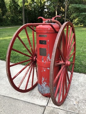

Q. I am a retired Firefighter doing research into early Twentieth Century Firefighting. I am currently examining the Chemical Engines of that era, which were oversized soda acid extinguishers on wheels. In the equipment catalogues, there are advertisements for the sulfuric acid used in these engines as being "66 degree sulfuric acid." I cannot figure out if the "66 degree" refer to the purity, specific gravity of the acid or something else. I am hoping you can tell me.
Yours truly,
Mark Hannon
historical research - Baltimore, Maryland, U.S.A.
A. It's 66 degrees Baumé, which is a hydrometer scale for density, and which equates to specific gravity of 1.84 times as heavy as water. What it's actually saying is that they contained sulfuric acid of full commercial concentration (about 98 percent pure). If the acid were more dilute, i.e., of lower concentration, its density would be lower, which means the degrees baumé would be lower.

thumbs up sign Hi Mark,
Thanks for raising this issue. I was recently visiting my son in Revelstoke, Canada and in the Fire Museum they had glass container that held sulfuric Acid and I was wondering why? The answer is now evident. Good luck with the rest of your research.
