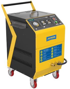

Q. I manufacture stainless steel tanks and we stored some tanks with the protective plastic film still attached. My problem is that the film is now very difficult to remove and we are having to use a steam cleaner on eBay or Amazon [affil link] which is time consuming. Is there an alternative which would not damage the brushed finish?
Charles Sargent
Custom made stainless steel products - Valletta, Malta
Dry Ice Blasting Machines
dry_ice_blaster
A. I have never heard of this problem but I think you should look into Dry ice blasting ⇨
This is a fast effective easy of removing adhesives or other problem substances from any surface.
