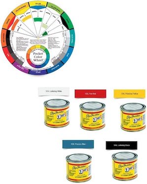

Q. I wonder how many people have used "One Shot" on metal mailboxes? I did two like that, and the paint was really durable -- but they're oil based, with turpentine on eBay or Amazon [affil link] cleanup. I'm looking for ideas for a waterbase durable alternative. Any suggestions?

A. Hi Jeni. I now see a bit of confusion here. When people asked about painting a mailbox, I and others assumed they meant to put a coat of paint on it -- black, white, or whatever color they wanted ...
But the "One Shot" that you are talking about is "sign paint"; it's intended for lettering, multiple distinctive colors on the same piece with freedom from brush marks, etc. The blog illustrated here suggests that regular latex house paint is not as good as "One Shot", but can be used for sign painting. Good luck.
