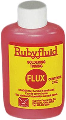

A. I re-tin copper cookware for a fund raiser at the National Ornamental Metal Museum every year. We use propane torches (the kind a plumber would use), ruby fluid (as a flux).
and pure tin. We don't worry about the temperature just get the pot hot enough to melt the tin so it can be wiped around the pot. A piece of cotton cloth wetted with flux is all you need to move the tin.
I know this is short but I learned from someone else and a lot of trial and error.
