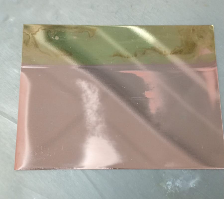

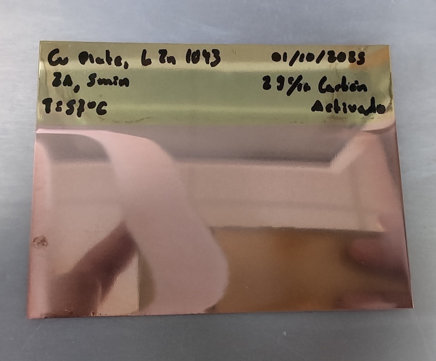

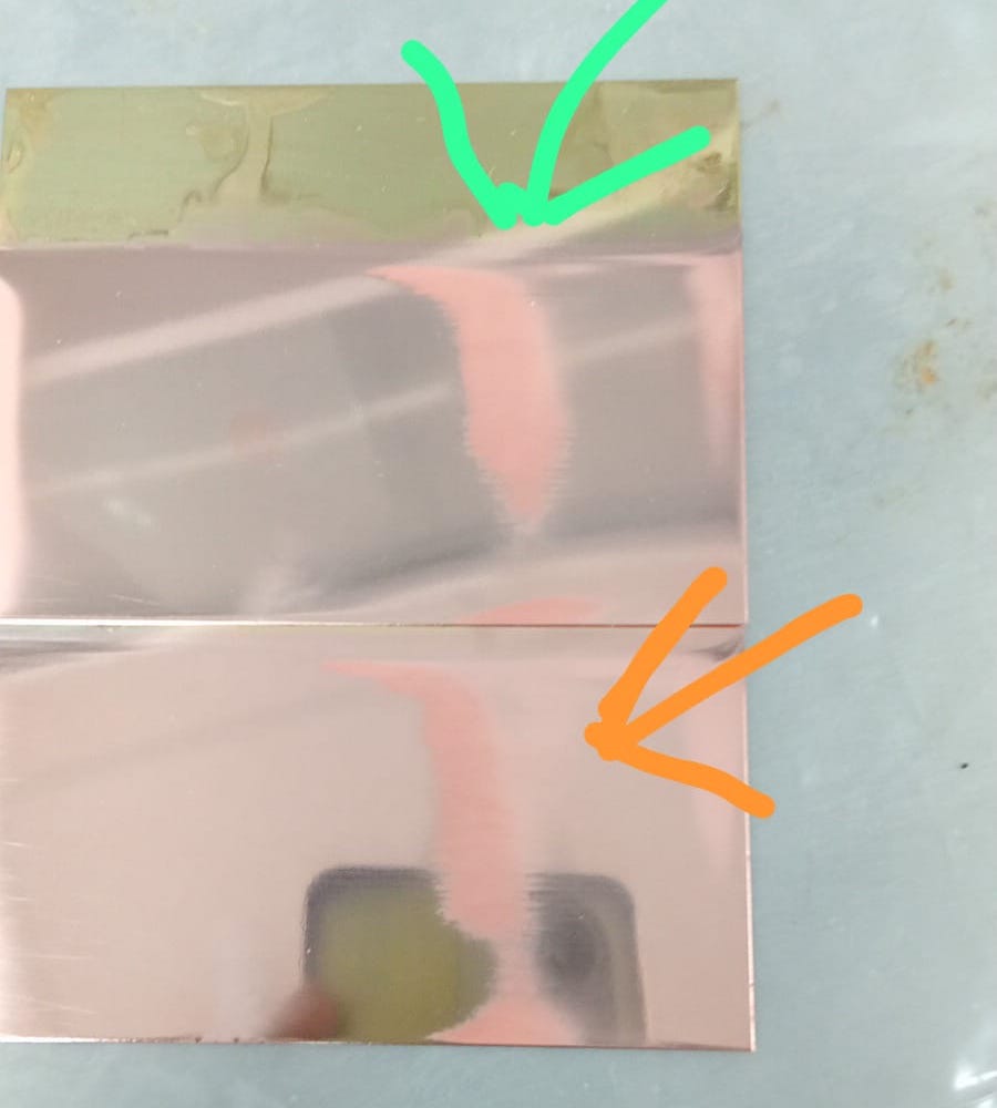

Q. Hello gentlemen, I hope you are doing well.
Currently I am working with cyanide copper plating applied to door hardware. My team and I prepare a new bath of cyanide copper (Copperlume from Atotech) to start the production of our product.
We started working really good without problems, but after one month my hull cell ⇦ ? shows some rare appearance in the medium/low density. We are trying to solve by adding more additive but after some loads the problem appears again. We are adding additives according to amperage, and we start to add more each start of shift to continue producing.
Someone has had the same problem?
Armando GarciaAME - Finishing - Queretaro/Mexico
February 6, 2026
A. Hi Armando,
I visited your beautiful town decades ago to help with the design of a new plating factory. I hope things are still lovely there!
Since you are apparently new to electroplating, you might not know that those additives you keep putting in deteriorate over time and must be removed. Do your filters include activated carbon for continuous treatment?
The fist pic seems to indicate that you did a batch carbon treatment immediately before it? I don't understand what we're seeing in that one, with swirls of different shapes all over the place. The other 3 panels are a bit out of focus, and indeed it's difficult to take good photos of Hull Cell panels, but they seem to exhibit a defect in a very narrow band. I suppose it could be a highly specific decomposition product, but I think you should seek advice on proper carbon treatment from Atotech -- they should be eager to help you.
