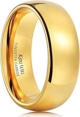

Q. Hi I'm thinking of purchasing a Lord of the Rings ring. It states that it is made of tungsten and combined with a small amount of nickel. It says it is 18k gold plated and will fade with fair wear and tear in two years time. Do you think it will start to tarnish before two years?
