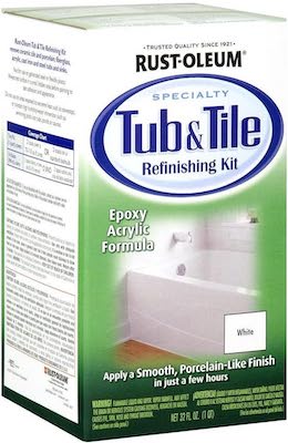

Q. I am looking for instructions to make the proper paint application, after making the proper preparations and obtaining the proper paint. Can you help me please ?
Sincerely,
Rae Hudson- Mesa, Arizona, USA
A. Hi Rae. Maybe try a kit offered for the purpose ⇨
and carefully follow its directions rather than trying to adapt other paints. But always accept that paint will never be porcelain :-(

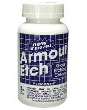

How much ABF and HF for bathtub etching?
Q. I am making an etching solution for etching porcelain bathtubs before refinishing them. I am adding a 49% Hydrofluoric acid mix at a 1:5 ratio, so 9.8 percent HF content. I need to know how much ammonium bifluoride to add. The tubs etch much better with a mix of HF and ABF but I'm not sure how to calculate the ABF.
I'm mixing 5 gallons at a time. How do I convert and calculate the ABF? Let's use 1 gallon of water as the example.
bathtub refinisher - Oregon USA

A. Hi Matt. This is a public forum, not a consulting service, so people naturally respond what triggers them according to their experience.
Although HF and ABF do much the same thing, the ammonia in ABF is a "buffer" which slows the reaction. The semiconductor industry reportedly uses a wide range of ratios depending on exactly how aggressive they wish the etching to be. Your competitors are unlikely to answer, and it's hard for people without specific experience in etching porcelain bathtubs to suggest how fast etching you would prefer, or how much is too much, and therefore how much ammonia you should add to slow it down.
My suggestion is to try small amounts of several commercial products like Armour Etch , Etchall Etching Cream, & several others ⇨
and see which works closest to what you want, then download their MSDS sheets which give their composition. It's probably a faster way to optimize than experimenting. Safe travels!
