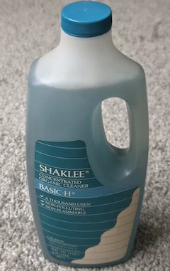

A. Floating gold can be settled by breaking the surface tension with a surfactant "jet dry" [Jet Dry on eBay or Amazon [affil link] comes to mind. Back in my youth we used to play with a Shaklee product called "Basic H"
... it was a wetting agent that would make water wetter and break surface tension. Most of the agents I can think of would work if you could drop small amounts in your sluice box as you run.
Good luck and hope you always see color in your pan!
